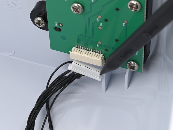

  14. Cricut Maker 3 Belt Replacement, Disconnect the button board: crwdns2935265:014crwdnd2935265:01crwdnd2935265:02crwdne2935265:0 Cricut Maker 3 Belt Replacement, Disconnect the button board: crwdns2935265:014crwdnd2935265:02crwdnd2935265:02crwdne2935265:0
  15. Cricut Maker 3 Belt Replacement: crwdns2935265:015crwdnd2935265:01crwdnd2935265:02crwdne2935265:0 Cricut Maker 3 Belt Replacement: crwdns2935265:015crwdnd2935265:02crwdnd2935265:02crwdne2935265:0
    • Peel up the tape securing the button wires to the inside of the top cover.
    • During reassembly, if this tape isn't sticking well, replace it with a piece of electrical tape to make sure these wires don't get caught in the gears.

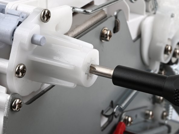

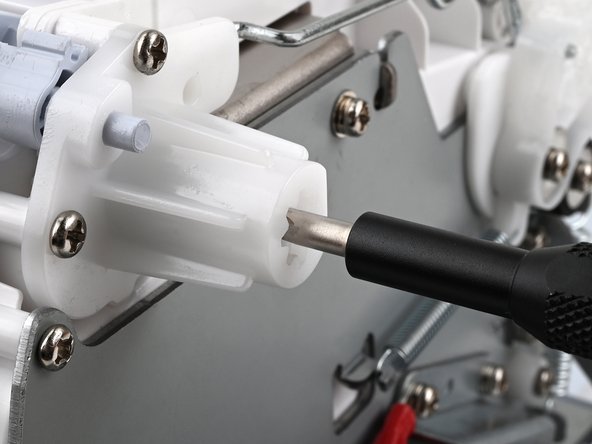

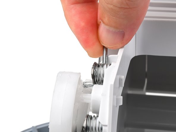

  17. Cricut Maker 3 Belt Replacement, Release the tension from both hinges: crwdns2935265:017crwdnd2935265:01crwdnd2935265:03crwdne2935265:0 Cricut Maker 3 Belt Replacement, Release the tension from both hinges: crwdns2935265:017crwdnd2935265:02crwdnd2935265:03crwdne2935265:0 Cricut Maker 3 Belt Replacement, Release the tension from both hinges: crwdns2935265:017crwdnd2935265:03crwdnd2935265:03crwdne2935265:0
    • There may be a significant amount of tension in the hinge. Hold your screwdriver firmly and let the tension release slowly.
    • Use a Phillips screwdriver to release the tension in the right hinge by pressing the inner portion of the hinge until it releases, then allowing it to turn clockwise until it comes to rest.
  18. Cricut Maker 3 Belt Replacement: crwdns2935265:018crwdnd2935265:01crwdnd2935265:03crwdne2935265:0 Cricut Maker 3 Belt Replacement: crwdns2935265:018crwdnd2935265:02crwdnd2935265:03crwdne2935265:0 Cricut Maker 3 Belt Replacement: crwdns2935265:018crwdnd2935265:03crwdnd2935265:03crwdne2935265:0
    • Use a Phillips screwdriver to release the tension in the left hinge by pressing the inner portion of the hinge until it releases, then allowing it to turn counterclockwise until it comes to rest.
    • During reassembly, use a Phillips screwdriver to tension the hinges by pressing the inner portion of each hinge inwards and turning it in the opposite direction until it is difficult to turn.

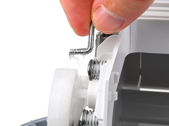

  19. Cricut Maker 3 Belt Replacement, Remove the tray release arm: crwdns2935265:019crwdnd2935265:01crwdnd2935265:03crwdne2935265:0 Cricut Maker 3 Belt Replacement, Remove the tray release arm: crwdns2935265:019crwdnd2935265:02crwdnd2935265:03crwdne2935265:0 Cricut Maker 3 Belt Replacement, Remove the tray release arm: crwdns2935265:019crwdnd2935265:03crwdnd2935265:03crwdne2935265:0
    • Only grip the spring by the hook on either end. Gripping the middle of the spring can deform it.
    • Use a pair of needle nose pliers or your fingers to lift the spring off of the tray release arm on the left end of the Cricut.
    • Some damping grease may hold this spring in place.
  20. Cricut Maker 3 Belt Replacement: crwdns2935265:020crwdnd2935265:01crwdnd2935265:02crwdne2935265:0 Cricut Maker 3 Belt Replacement: crwdns2935265:020crwdnd2935265:02crwdnd2935265:02crwdne2935265:0
    • Remove the bottom of the spring from the tension screw and set the spring aside.
  21. Cricut Maker 3 Belt Replacement: crwdns2935265:021crwdnd2935265:01crwdnd2935265:03crwdne2935265:0 Cricut Maker 3 Belt Replacement: crwdns2935265:021crwdnd2935265:02crwdnd2935265:03crwdne2935265:0 Cricut Maker 3 Belt Replacement: crwdns2935265:021crwdnd2935265:03crwdnd2935265:03crwdne2935265:0

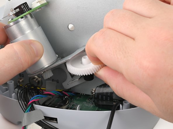

  37. Cricut Maker 3 Belt Replacement: crwdns2935265:037crwdnd2935265:01crwdnd2935265:01crwdne2935265:0
    • Use a Phillips screwdriver to remove the two 7.4 mm‑long screws securing the right motor.
  38. Cricut Maker 3 Belt Replacement: crwdns2935265:038crwdnd2935265:01crwdnd2935265:03crwdne2935265:0 Cricut Maker 3 Belt Replacement: crwdns2935265:038crwdnd2935265:02crwdnd2935265:03crwdne2935265:0 Cricut Maker 3 Belt Replacement: crwdns2935265:038crwdnd2935265:03crwdnd2935265:03crwdne2935265:0
    • Rotate the motor counterclockwise one quarter turn to expose the E‑clip under the gear.
    • Use a small flathead screwdriver or other rigid prying tool to remove the E‑clip from the bottom of the right motor bracket.

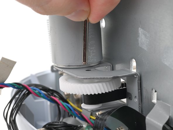

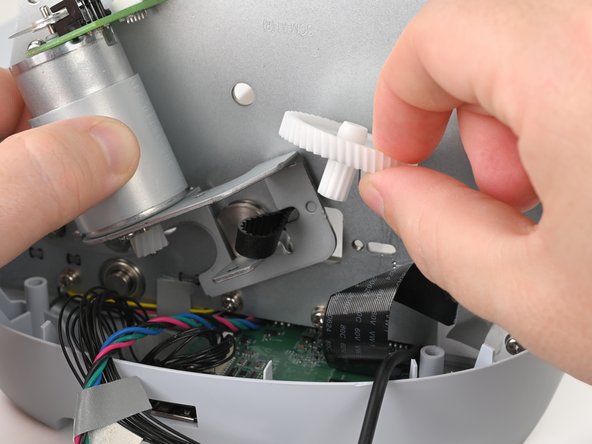

  39. Cricut Maker 3 Belt Replacement: crwdns2935265:039crwdnd2935265:01crwdnd2935265:02crwdne2935265:0 Cricut Maker 3 Belt Replacement: crwdns2935265:039crwdnd2935265:02crwdnd2935265:02crwdne2935265:0
    • Lift the pin securing the gears out of the top of the right motor bracket.
  40. Cricut Maker 3 Belt Replacement: crwdns2935265:040crwdnd2935265:01crwdnd2935265:02crwdne2935265:0 Cricut Maker 3 Belt Replacement: crwdns2935265:040crwdnd2935265:02crwdnd2935265:02crwdne2935265:0

  41. Cricut Maker 3 Belt Replacement: crwdns2935265:041crwdnd2935265:01crwdnd2935265:03crwdne2935265:0 Cricut Maker 3 Belt Replacement: crwdns2935265:041crwdnd2935265:02crwdnd2935265:03crwdne2935265:0 Cricut Maker 3 Belt Replacement: crwdns2935265:041crwdnd2935265:03crwdnd2935265:03crwdne2935265:0
    • The gear you remove in this step has a small cap at its bottom that will fall off when you slide the gear out of the bracket. Be careful not to lose it.
    • With one hand holding the motor, use your other hand to remove the gear from the motor bracket.
    • This part can be tricky. Adjust the motor and pull the gear at different angles until it comes free.
    • As the gear comes free of the bracket, lift the gear out of the belt.
    • During reassembly:
    • Thread the belt through the opening in the motor bracket.
    • Insert the smaller part of the gear into the belt and replace the cap on the bottom of the gear.
    • Hold the gear, belt, and cap in place as you place the gear into the motor bracket.

    • Use a small flathead screwdriver or other rigid prying tool to remove the E‑clip from the bottom of the left bracket assembly.
  45. Cricut Maker 3 Belt Replacement: crwdns2935265:045crwdnd2935265:01crwdnd2935265:03crwdne2935265:0 Cricut Maker 3 Belt Replacement: crwdns2935265:045crwdnd2935265:02crwdnd2935265:03crwdne2935265:0 Cricut Maker 3 Belt Replacement: crwdns2935265:045crwdnd2935265:03crwdnd2935265:03crwdne2935265:0
    • Lift the pin securing the gear out of the left bracket assembly bracket.
    • Remove the gear, allowing the belt to fall out of the bracket.
