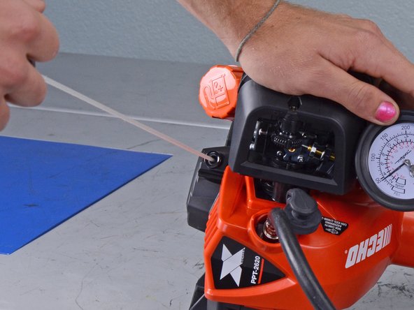

  5. Compression Test, Connect a compression tester: crwdns2935265:05crwdnd2935265:01crwdnd2935265:01crwdne2935265:0
    • Follow the instruction provided with your compression test kit to connect a compression tester to the cylinder.
  6. Compression Test, Test compression: crwdns2935265:06crwdnd2935265:01crwdnd2935265:02crwdne2935265:0 Compression Test, Test compression: crwdns2935265:06crwdnd2935265:02crwdnd2935265:02crwdne2935265:0
    • Pull the starter 5–10 times to build pressure in the combustion chamber.
  7. Compression Test: crwdns2935265:07crwdnd2935265:01crwdnd2935265:01crwdne2935265:0
    • Read the compression gauge.
    • Pressure should read 125–165 psi (8.6–11.4 bar).
