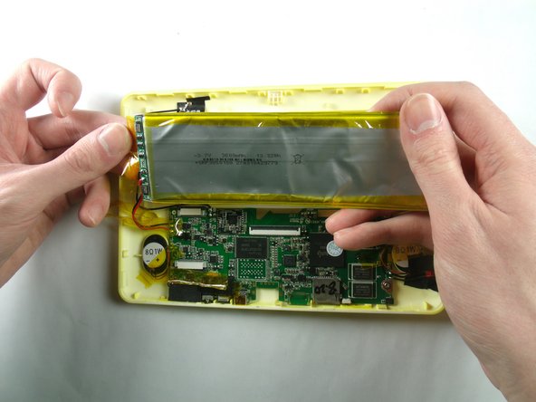

      • Using the iFix it opening tool, pry battery apart from back side of tablet.
      • The battery is connected to the back side by a strong adhesive.
      • The battery may bend during this process.
      • Be careful not to allow the battery to bend any more than necessary. Battery acid leakage is possible.
      • Be careful not to damage the wires or the black tab attached to the battery.
    3. ClickN Kids Tablet Battery Replacement: crwdns2935265:03crwdnd2935265:01crwdnd2935265:03crwdne2935265:0 ClickN Kids Tablet Battery Replacement: crwdns2935265:03crwdnd2935265:02crwdnd2935265:03crwdne2935265:0 ClickN Kids Tablet Battery Replacement: crwdns2935265:03crwdnd2935265:03crwdnd2935265:03crwdne2935265:0
      • Gently remove tape from the side of the battery connecting to wires and circuits.
    4. ClickN Kids Tablet Battery Replacement: crwdns2935265:04crwdnd2935265:01crwdnd2935265:03crwdne2935265:0 ClickN Kids Tablet Battery Replacement: crwdns2935265:04crwdnd2935265:02crwdnd2935265:03crwdne2935265:0 ClickN Kids Tablet Battery Replacement: crwdns2935265:04crwdnd2935265:03crwdnd2935265:03crwdne2935265:0
      • Desolder wires connecting battery to motherboard, using contact points found on motherboard.
      • Have someone who is skilled in soldering to perform this step.
      • Be careful not to destroy the motherboard or other parts of device.

A little then moderate skill is necessary if you are somewhat mechanically inclined shouldn't be too problematic. But as far as this gentleman's directions and steps perform the task with no problems and tablet works now. Thank you Kevin Finney and three others my four-year-old daughter Hazel is happy again thanks to you.
