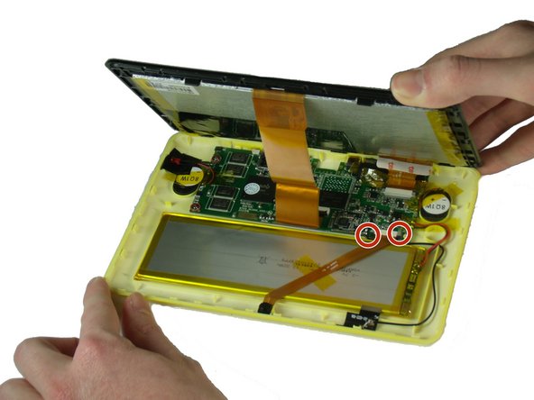

    3. ClickN Kids Tablet Camera Replacement: crwdns2935265:03crwdnd2935265:01crwdnd2935265:01crwdne2935265:0

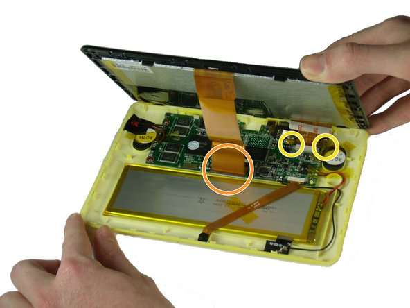

      • Lift the detached screen from the camera side until you can see the inside of the tablet.
      • Don't open too fast, or you might damage the ribbons cables.
    4. ClickN Kids Tablet Camera Replacement: crwdns2935265:04crwdnd2935265:01crwdnd2935265:02crwdne2935265:0 ClickN Kids Tablet Camera Replacement: crwdns2935265:04crwdnd2935265:02crwdnd2935265:02crwdne2935265:0
      • Be careful not to damage any wires or ribbon cables during this step.
      • There are two ribbon cables to remove during this step. Each is connected to a base on the motherboard.
      • There is a black tab behind the long ribbon cable. Lift up the black tab.
      • For the ribbon cable in the back, pull the black tabs on the side out.
      • Detach the ribbon cables connecting the screen to the motherboard.
      • Remove any tape that is holding down the ribbon cables. Set it aside.

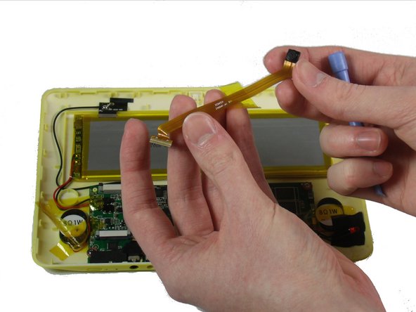

      • Be careful not to damage the wires or ribbon cables.
      • Pull out the two black ends of the base on the motherboard.
      • Slide out the camera’s ribbon cable once the ends are loosened.
    7. ClickN Kids Tablet Camera Replacement: crwdns2935265:07crwdnd2935265:01crwdnd2935265:03crwdne2935265:0 ClickN Kids Tablet Camera Replacement: crwdns2935265:07crwdnd2935265:02crwdnd2935265:03crwdne2935265:0 ClickN Kids Tablet Camera Replacement: crwdns2935265:07crwdnd2935265:03crwdnd2935265:03crwdne2935265:0

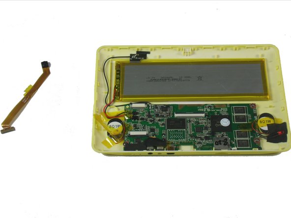

      • Use a plastic opening tool to pry the camera out of its place.
