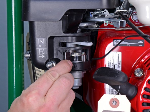

    • Flip the gas shutoff switch next to the motor to the left into the off position.

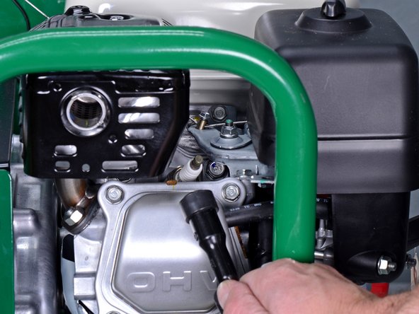

    • Grab the plastic housing at the end of the spark plug wire.
    • Pull firmly to disconnect the wire from the spark plug.

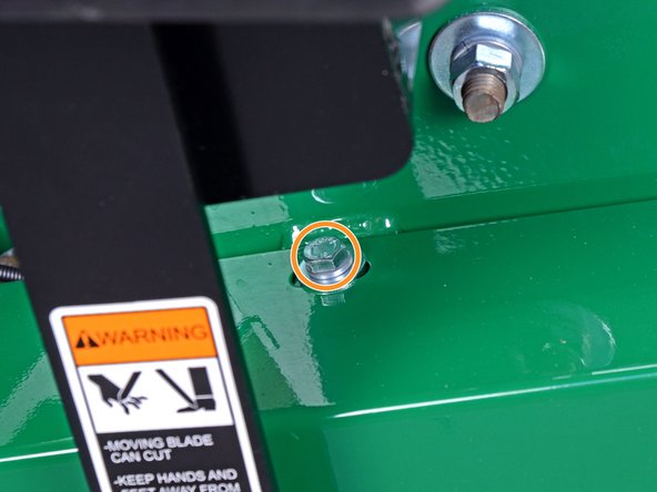

  5. Classen Sod Cutter HSC18AHD 2018 Upper V-Belt Replacement, Remove the belt shield: crwdns2935265:05crwdnd2935265:01crwdnd2935265:02crwdne2935265:0 Classen Sod Cutter HSC18AHD 2018 Upper V-Belt Replacement, Remove the belt shield: crwdns2935265:05crwdnd2935265:02crwdnd2935265:02crwdne2935265:0
    • Use a 1/2 inch socket to remove the first two bolts from the belt shield.
    • Use a 1/2 inch socket to remove the third bolt from the belt shield.
  6. Classen Sod Cutter HSC18AHD 2018 Upper V-Belt Replacement: crwdns2935265:06crwdnd2935265:01crwdnd2935265:02crwdne2935265:0 Classen Sod Cutter HSC18AHD 2018 Upper V-Belt Replacement: crwdns2935265:06crwdnd2935265:02crwdnd2935265:02crwdne2935265:0
    • Remove the belt shield.
