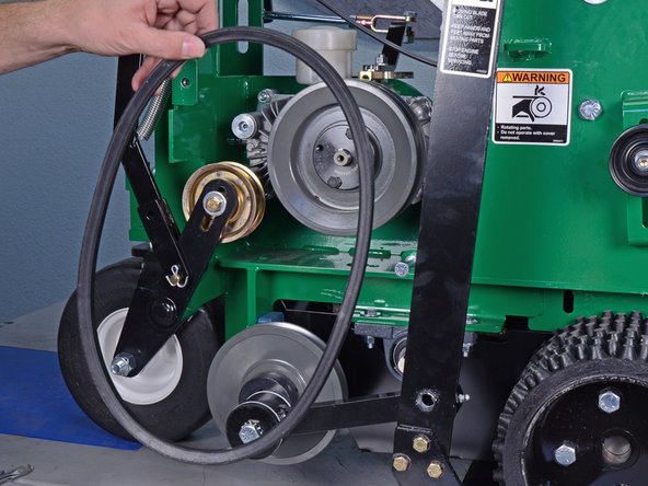

  9. Classen Sod Cutter HSC18AHD 2018 Lower V-Belt Replacement: crwdns2935265:09crwdnd2935265:01crwdnd2935265:01crwdne2935265:0
    • Raise the idler pulley to relieve the tension from the V-belt.
  10. Classen Sod Cutter HSC18AHD 2018 Lower V-Belt Replacement: crwdns2935265:010crwdnd2935265:01crwdnd2935265:01crwdne2935265:0
    • Remove the V-belt.
  11. Classen Sod Cutter HSC18AHD 2018 Lower V-Belt Replacement, Reassembly tip: crwdns2935265:011crwdnd2935265:01crwdnd2935265:01crwdne2935265:0
    • Check that the idler pulley is properly tensioning the belt:
    • Use your fingers to roll the belt. If you cannot twist the belt more than a quarter turn, the belt is sufficiently tensioned. If the belt is too loose, set the idler pulley lower to tension the belt more.

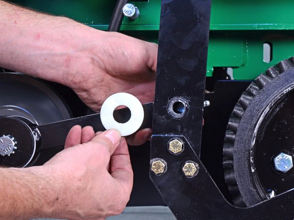

  12. Classen Sod Cutter HSC18AHD 2018 Lower V-Belt Replacement, Remove the lower V-belt: crwdns2935265:012crwdnd2935265:01crwdnd2935265:01crwdne2935265:0
    • Use a 3/4 inch socket to remove the bolt securing the eccentric arm to the blade arm.
    • You may need to use a 3/4 inch wrench in combination with the socket wrench to hold the nut in place.
  13. Classen Sod Cutter HSC18AHD 2018 Lower V-Belt Replacement: crwdns2935265:013crwdnd2935265:01crwdnd2935265:02crwdne2935265:0 Classen Sod Cutter HSC18AHD 2018 Lower V-Belt Replacement: crwdns2935265:013crwdnd2935265:02crwdnd2935265:02crwdne2935265:0
    • Remove the plastic washer from in between the eccentric arm and the blade arm.
  14. Classen Sod Cutter HSC18AHD 2018 Lower V-Belt Replacement: crwdns2935265:014crwdnd2935265:01crwdnd2935265:01crwdne2935265:0
    • Remove the partially threaded bolt and plastic washer.
    • During reassembly, apply threadlocker on the bolt threads.
  15. Classen Sod Cutter HSC18AHD 2018 Lower V-Belt Replacement, Remove the lower V-belt: crwdns2935265:015crwdnd2935265:01crwdnd2935265:01crwdne2935265:0
    • Move the cutter blade handle back to disengage the blade drive and relieve tension on the V-belt.
  16. Classen Sod Cutter HSC18AHD 2018 Lower V-Belt Replacement: crwdns2935265:016crwdnd2935265:01crwdnd2935265:02crwdne2935265:0 Classen Sod Cutter HSC18AHD 2018 Lower V-Belt Replacement: crwdns2935265:016crwdnd2935265:02crwdnd2935265:02crwdne2935265:0
    • Lift the eccentric arm to open a space to remove the V-belt.
  17. Classen Sod Cutter HSC18AHD 2018 Lower V-Belt Replacement, Reassembly tip: crwdns2935265:017crwdnd2935265:01crwdnd2935265:01crwdne2935265:0
    • When installing the new V-belt, ensure it is placed to the left of the bolt as pictured.
