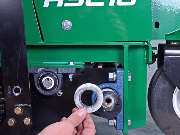

    • Remove the plastic washer from between the eccentric arm and the blade arm.

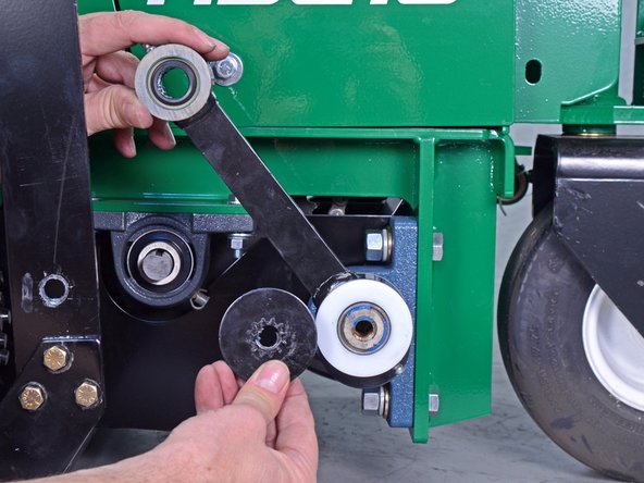

  7. Classen Sod Cutter HSC18AHD 2018 Eccentric Arm Replacement: crwdns2935265:07crwdnd2935265:01crwdnd2935265:01crwdne2935265:0
    • Lift the eccentric arm away from the blade arm.

    • Remove the steel washer from the eccentric shaft.

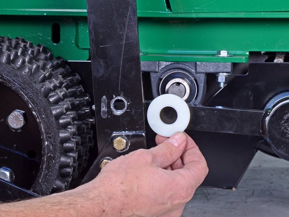

  9. Classen Sod Cutter HSC18AHD 2018 Eccentric Arm Replacement: crwdns2935265:09crwdnd2935265:01crwdnd2935265:01crwdne2935265:0
    • Remove the plastic washer from the eccentric shaft.
  10. Classen Sod Cutter HSC18AHD 2018 Eccentric Arm Replacement: crwdns2935265:010crwdnd2935265:01crwdnd2935265:02crwdne2935265:0 Classen Sod Cutter HSC18AHD 2018 Eccentric Arm Replacement: crwdns2935265:010crwdnd2935265:02crwdnd2935265:02crwdne2935265:0
    • Remove the eccentric arm and plastic washer from the eccentric shaft.
    • Repeat steps 5–10 for the other eccentric arm.
    • During reassembly, use a grease gun to add grease to the bearings through the two Zerk fittings on each eccentric arm.
