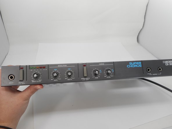

Boss CE-300 Super Chorus Switches Replacement
  1. Boss CE-300 Super Chorus Switches Replacement, Top Panel: crwdns2935265:01crwdnd2935265:01crwdnd2935265:01crwdne2935265:0
    • Use a Phillips #2 screwdriver to remove the 3 14.8 mm screws located on the left side of the CE-300.
    • Repeat the previous bullet on the right side.
  2. Boss CE-300 Super Chorus Switches Replacement: crwdns2935265:02crwdnd2935265:01crwdnd2935265:01crwdne2935265:0
    • Remove the two 10 mm bolts using a Phillips #2 screwdriver.
  3. Boss CE-300 Super Chorus Switches Replacement: crwdns2935265:03crwdnd2935265:01crwdnd2935265:01crwdne2935265:0
    • On the back of the CE-300, remove the two 7.5 mm screws with a Phillips #2 screwdriver.
  4. Boss CE-300 Super Chorus Switches Replacement: crwdns2935265:04crwdnd2935265:01crwdnd2935265:01crwdne2935265:0
    • On the left side, remove the one 10 mm screws with a Phillips #2 screwdriver.
  5. Boss CE-300 Super Chorus Switches Replacement: crwdns2935265:05crwdnd2935265:01crwdnd2935265:02crwdne2935265:0 Boss CE-300 Super Chorus Switches Replacement: crwdns2935265:05crwdnd2935265:02crwdnd2935265:02crwdne2935265:0
    • Slide the top panel away from the front.
    • Lift the panel up and off.

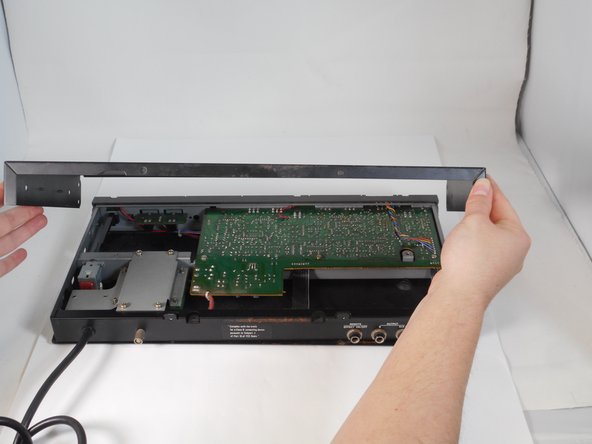

  6. Boss CE-300 Super Chorus Switches Replacement, Bottom Panel: crwdns2935265:06crwdnd2935265:01crwdnd2935265:01crwdne2935265:0
    • Remove the following screws with a Phillips #2 screwdriver:​
    • Two 7.5 mm
    • Two 10 mm
  7. Boss CE-300 Super Chorus Switches Replacement: crwdns2935265:07crwdnd2935265:01crwdnd2935265:02crwdne2935265:0 Boss CE-300 Super Chorus Switches Replacement: crwdns2935265:07crwdnd2935265:02crwdnd2935265:02crwdne2935265:0
    • Lift the bottom panel up and off.

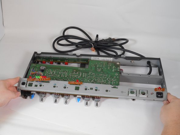

  15. Boss CE-300 Super Chorus Switches Replacement: crwdns2935265:015crwdnd2935265:01crwdnd2935265:02crwdne2935265:0 Boss CE-300 Super Chorus Switches Replacement: crwdns2935265:015crwdnd2935265:02crwdnd2935265:02crwdne2935265:0
    • Remove the two audio jacks that are to the side.
    • Do not pull the face bracket fully off and away. Some cables will remain attached to the face bracket and to the board.
    • Carefully remove the face bracket by sliding it forward until it clears all dials, then lift up.

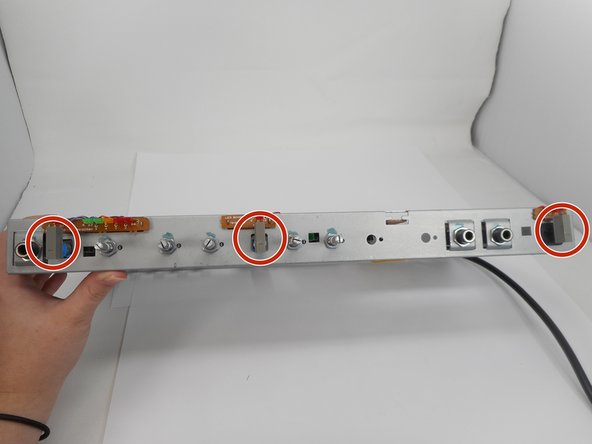

  16. Boss CE-300 Super Chorus Switches Replacement, Switches: crwdns2935265:016crwdnd2935265:01crwdnd2935265:02crwdne2935265:0 Boss CE-300 Super Chorus Switches Replacement, Switches: crwdns2935265:016crwdnd2935265:02crwdnd2935265:02crwdne2935265:0
    • From the "top" of the board, desolder the marked joints.
    • For some switches, the board is labeled to help identify the correct switch. The switch shown in the second picture is the "Direct Mute" switch.
