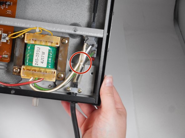

  8. Boss CE-300 Super Chorus Power Supply and Power Cable Replacement, Power Supply and Power Cable: crwdns2935265:08crwdnd2935265:01crwdnd2935265:01crwdne2935265:0
    • To remove the power supply, you have to look to the power cable.
    • Remove the two 17 mm screws with a Phillips #2 screwdriver.
    • The screws are very tight. Avoid slipping with the screwdriver. Hitting the board may damage the unit.
    • Remove the white bracket pieces that come loose with the removal of the two screws.
  9. Boss CE-300 Super Chorus Power Supply and Power Cable Replacement: crwdns2935265:09crwdnd2935265:01crwdnd2935265:01crwdne2935265:0
    • Push the power cable in toward the unit.
    • This allows you to visualize the solder joints on the power switch.

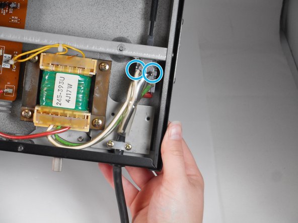

  10. Boss CE-300 Super Chorus Power Supply and Power Cable Replacement: crwdns2935265:010crwdnd2935265:01crwdnd2935265:02crwdne2935265:0 Boss CE-300 Super Chorus Power Supply and Power Cable Replacement: crwdns2935265:010crwdnd2935265:02crwdnd2935265:02crwdne2935265:0
    • If you are just replacing the power supply, desolder the white and green wire.
    • If you are replacing the power cable as well, desolder the white and black cable of the power cable as well.
