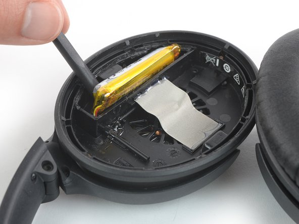

    • Try not to deform or puncture the battery during the following removal process. Soft-shell lithium-ion batteries can leak dangerous chemicals, catch fire, or even explode if damaged.
    • Insert the flat end of a spudger between the battery and the battery well.
    • Carefully pry the battery out of its recess.
    • You might want to change the position of the spudger a couple of times during this process to avoid excessive force to a single point of the battery.
  14. Bose QuietComfort 35 Battery Replacement: crwdns2935265:014crwdnd2935265:01crwdnd2935265:03crwdne2935265:0 Bose QuietComfort 35 Battery Replacement: crwdns2935265:014crwdnd2935265:02crwdnd2935265:03crwdne2935265:0 Bose QuietComfort 35 Battery Replacement: crwdns2935265:014crwdnd2935265:03crwdnd2935265:03crwdne2935265:0
    • Remove the battery.
    • Do not reinstall a damaged or deformed battery, as doing so is a potential safety hazard. Replace it with a new battery.
