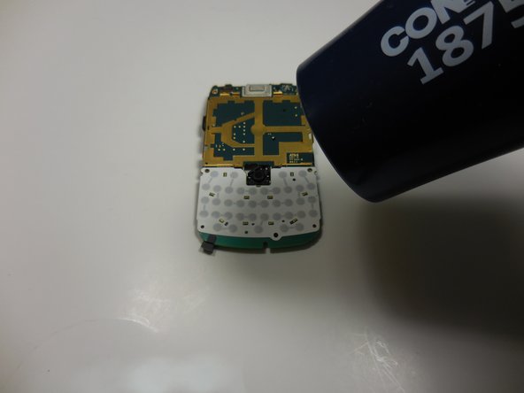

    • Use a conventional hair dryer to heat up the keyboard membrane.
    • On medium or low heat evenly heat up the membrane in the range of 5 to 10 minutes
    • Do not over heat the keyboard membrane. It should become soft to the touch when ready.
    • Removing the trackpad and LCD display prior to this repair is optional. Follow this guide to remove the trackpad, and this guide to remove the LCD display.

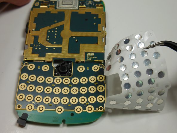

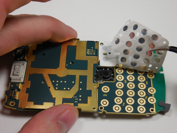

    • Use a pair of tweezers to gently peal away the keyboard membrane.
    • Start from one of the top corners and regrip membrane in the center to completly remove the membrane.

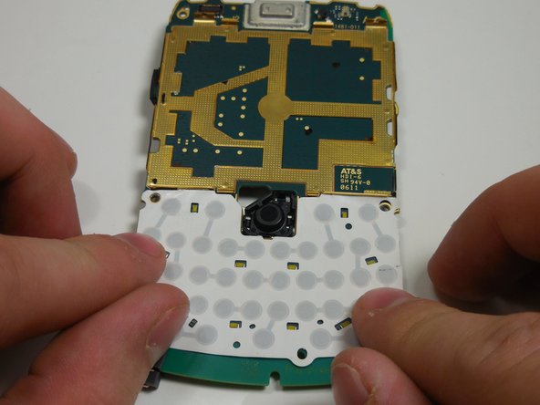

  13. BlackBerry Bold 9700 Keyboard Membrane Replacement: crwdns2935265:013crwdnd2935265:01crwdnd2935265:02crwdne2935265:0 BlackBerry Bold 9700 Keyboard Membrane Replacement: crwdns2935265:013crwdnd2935265:02crwdnd2935265:02crwdne2935265:0
    • Align the new keyboard membrane with gold conduits and press down onto circuit board.
