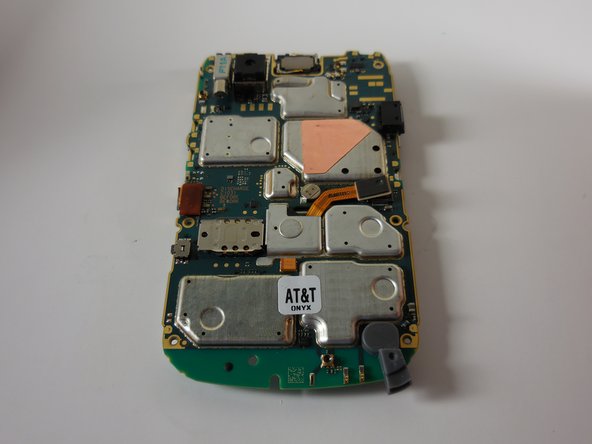

    • Grip the motherboard by the screen
    • Lift the board away from the base of the housing and vertically up.

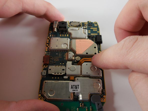

  11. BlackBerry Bold 9700 Trackpad Replacement, Trackpad: crwdns2935265:011crwdnd2935265:01crwdnd2935265:03crwdne2935265:0 BlackBerry Bold 9700 Trackpad Replacement, Trackpad: crwdns2935265:011crwdnd2935265:02crwdnd2935265:03crwdne2935265:0 BlackBerry Bold 9700 Trackpad Replacement, Trackpad: crwdns2935265:011crwdnd2935265:03crwdnd2935265:03crwdne2935265:0

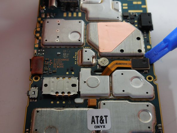

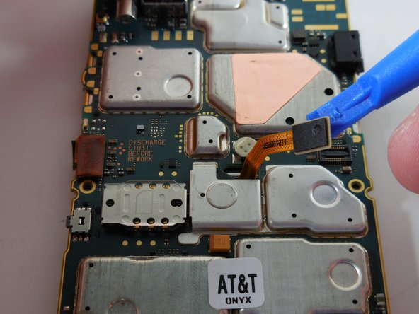

    • Flip the board over so that the LCD display is against the the surface of your work space.
    • Use a plastic opening tool to gently remove the ribbon connector located on the right-hand side of the board.
    • Ribbon cables are fragile. Be gentle when working with ribbon cables.

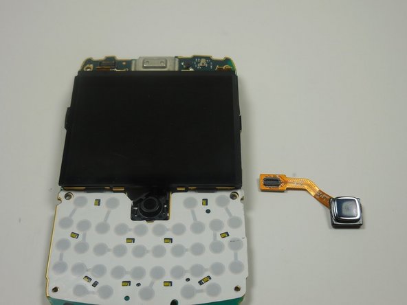

  12. BlackBerry Bold 9700 Trackpad Replacement: crwdns2935265:012crwdnd2935265:01crwdnd2935265:02crwdne2935265:0 BlackBerry Bold 9700 Trackpad Replacement: crwdns2935265:012crwdnd2935265:02crwdnd2935265:02crwdne2935265:0
    • Gently grip the trackpad.
    • Pull the ribbon cable through the slot in the board.
  13. BlackBerry Bold 9700 Trackpad Replacement: crwdns2935265:013crwdnd2935265:01crwdnd2935265:03crwdne2935265:0 BlackBerry Bold 9700 Trackpad Replacement: crwdns2935265:013crwdnd2935265:02crwdnd2935265:03crwdne2935265:0 BlackBerry Bold 9700 Trackpad Replacement: crwdns2935265:013crwdnd2935265:03crwdnd2935265:03crwdne2935265:0
    • Insert the ribbon connector of your new trackpad through the slot in the board.
    • Align the ribbon connector with the connection point.
    • Gently press the ribbon connector into place.
