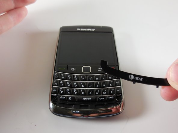

    • Pry off the AT&T logo panel with the plastic opening tool.
    • You will hear a snapping sound as the plastic tabs pop out.

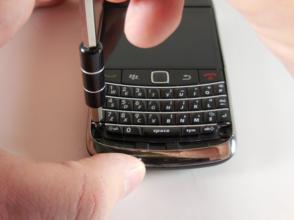

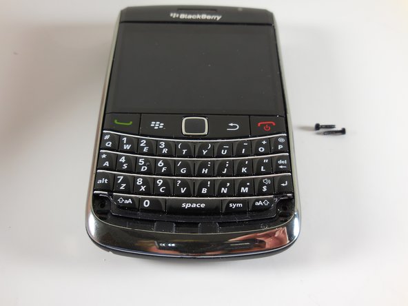

    • Use your T5 Torx screwdriver to remove the two black 5.57mm Torx head screws underneath the keyboard.

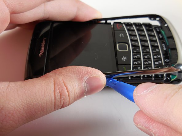

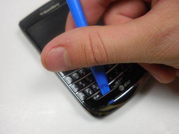

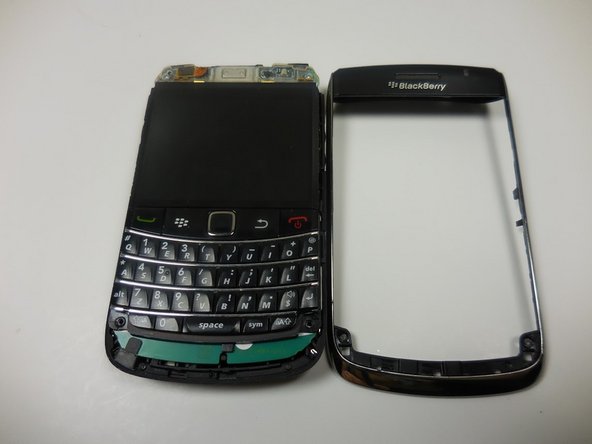

    • Use the plastic opening tool to remove the frame of your device.
    • You will hear a snapping sound as the tabs pop out.
    • Once the case is loosened from the device, slide the case away from the top of the phone.

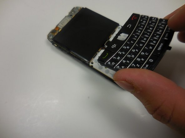

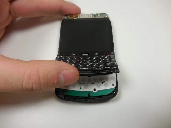

    • Gently lift the bottom of the keyboard upward.
    • Pull the keyboard away from the bottom of the LCD display and lift upward.

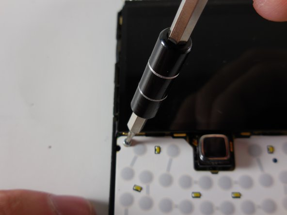

    • Remove the two Torx head 4.13mm steel screws with your T5 Torx screwdriver.
  8. BlackBerry Bold 9700 LCD Display Replacement: crwdns2935265:08crwdnd2935265:01crwdnd2935265:03crwdne2935265:0 BlackBerry Bold 9700 LCD Display Replacement: crwdns2935265:08crwdnd2935265:02crwdnd2935265:03crwdne2935265:0 BlackBerry Bold 9700 LCD Display Replacement: crwdns2935265:08crwdnd2935265:03crwdnd2935265:03crwdne2935265:0

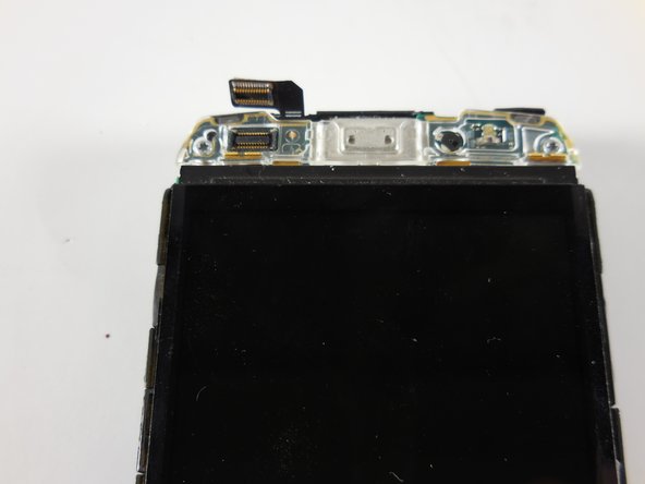

    • Gently pry up the ribbon connector at the top of the phone with a plastic opening tool.
    • Ribbon connectors are fragile. Too much force in the wrong place will damage the ribbon and may force you to replace an entire assembly.

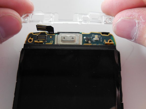

    • Remove the top two Torx head 4.13mm steel screws with your T5 Torx screwdriver.
    • You should now have two 5.57mm black torx head screws and four 4.13mm steel Torx head screws off to the side. Do not lose them.
    • Lift the clear plastic cover directly upward.

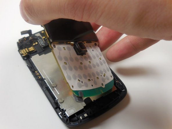

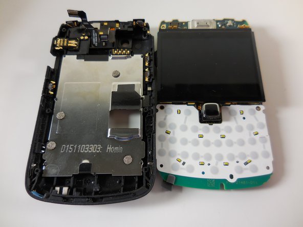

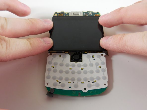

    • Grip the motherboard by the screen
    • Lift the board away from the base of the housing and vertically up.

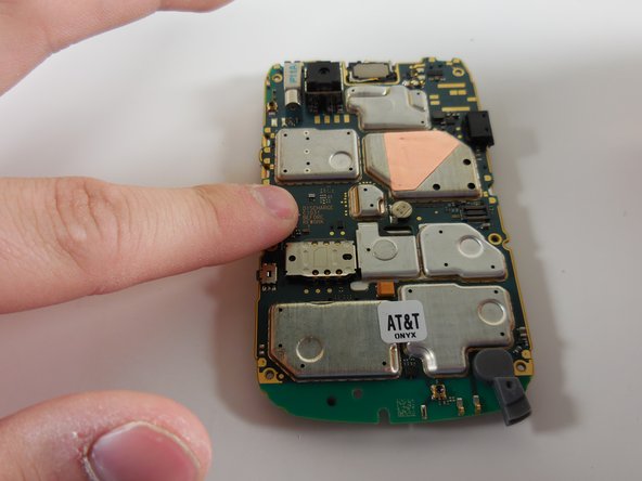

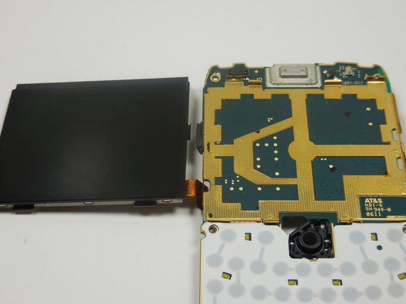

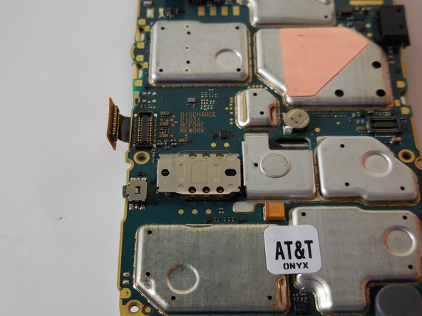

    • Flip the motherboard over so that the LCD display is flush with the surface of your work space.

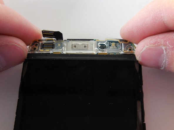

    • Use a plastic opening tool to gently pry up the ribbon connector located on the left hand side of the motherboard.
    • Be gentle. Ribbon connectors are very fragile.

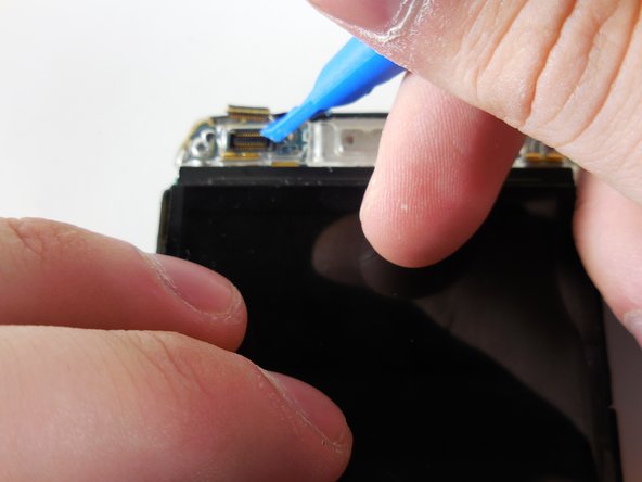

    • Use a plastic opening tool to gently pry back the two golden metal brackets at the top of the display.

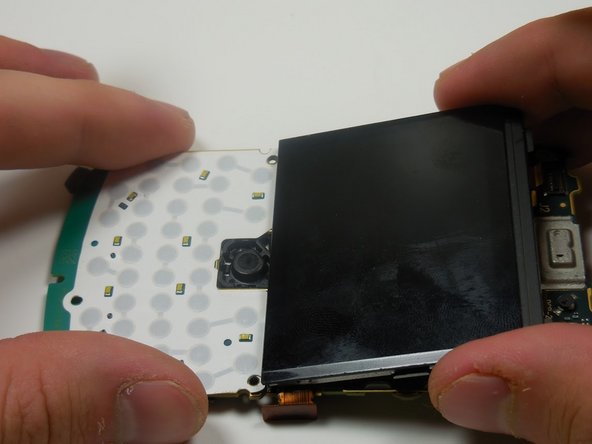

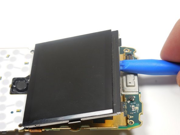

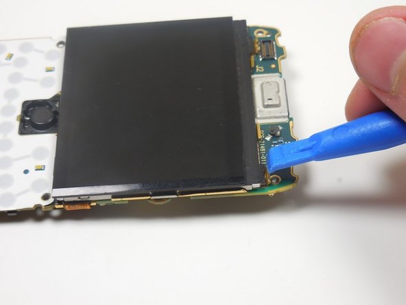

    • Use a plastic opening tool to pry the LCD display off the board.
    • The screen is held onto the board by two strong adhesive pads. You will need to pry vigorously. Do not be afraid of breaking the board. The screen will come off well before the board snaps.
    • Removing the trackpad prior to this repair is optional. If you wish to do so, follow this guide for removal instructions.
