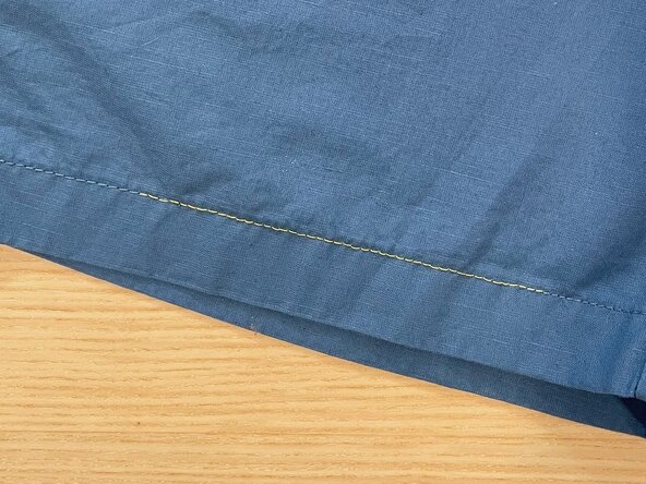

    • The backstitch is one of the strongest hand sewing stitches.
    • Structure - This technique forms a solid line of stitches on the fabric surface while creating a double-length stitch on the backside.
    • Repair Use - Commonly used in hand sewn repairs as a substitute for machine stitching. Its looping structure provides strength, stability, and slight elasticity when pulled.

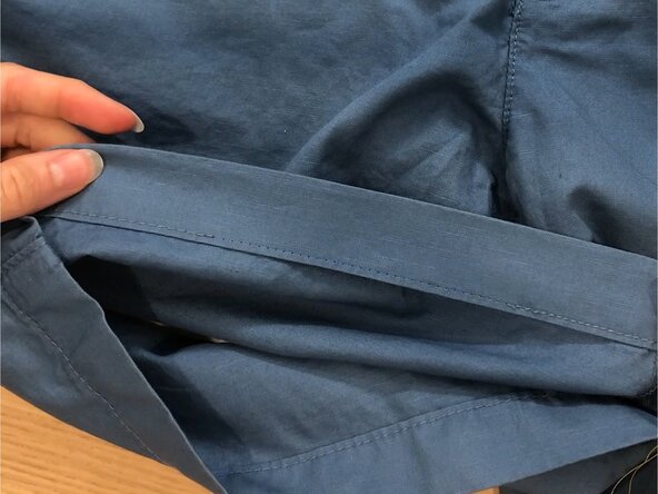

  2. Backstitch on a Loose Hem, Assess the damage: crwdns2935265:02crwdnd2935265:01crwdnd2935265:03crwdne2935265:0 Backstitch on a Loose Hem, Assess the damage: crwdns2935265:02crwdnd2935265:02crwdnd2935265:03crwdne2935265:0 Backstitch on a Loose Hem, Assess the damage: crwdns2935265:02crwdnd2935265:03crwdnd2935265:03crwdne2935265:0

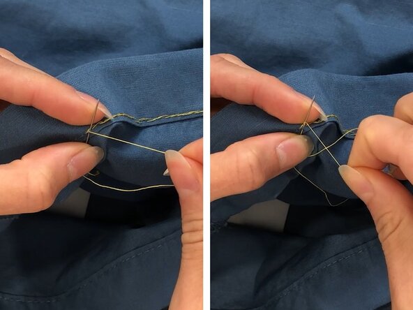

    • Locate the area with missing stitching and trim away any loose or hanging threads.
    • Mark the new stitch line with chalk or a heat-erasable pen.
    • If stitch holes from the previous stitching are visible, these can be used as a guide for the new stitch line.
    • If the opening is larger than a few inches, use pins or binder clips to secure the pieces of fabric together while sewing.

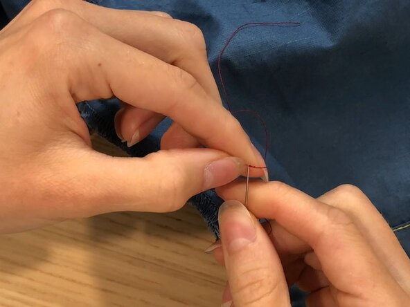

  3. Backstitch on a Loose Hem, Start the stitch: crwdns2935265:03crwdnd2935265:01crwdnd2935265:03crwdne2935265:0 Backstitch on a Loose Hem, Start the stitch: crwdns2935265:03crwdnd2935265:02crwdnd2935265:03crwdne2935265:0 Backstitch on a Loose Hem, Start the stitch: crwdns2935265:03crwdnd2935265:03crwdnd2935265:03crwdne2935265:0

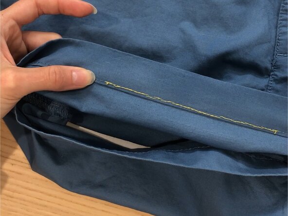

    • Thread the needle with a length of thread approximately 24 inches (~61 cm) long and tie a knot at one end of the thread. For more details see Needles and Thread.
    • The pictured repair uses contrast thread for visibility, but matching thread will make this repair almost invisible.
    • From the backside of the seam, pierce the needle through to the front, overlapping any existing stitching by at least 1/2 inch (~13 mm).
    • If the seam doesn't have a front and backside, choose either.
    • Pull the thread through until the knot lies flush against the fabric.

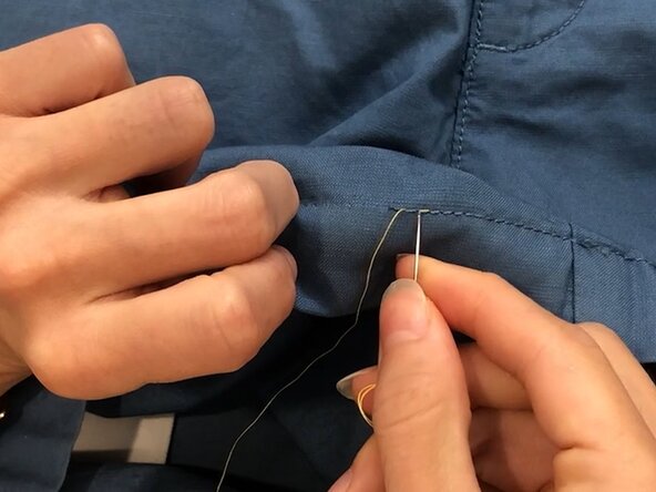

  4. Backstitch on a Loose Hem, Make the backstitch: crwdns2935265:04crwdnd2935265:01crwdnd2935265:03crwdne2935265:0 Backstitch on a Loose Hem, Make the backstitch: crwdns2935265:04crwdnd2935265:02crwdnd2935265:03crwdne2935265:0 Backstitch on a Loose Hem, Make the backstitch: crwdns2935265:04crwdnd2935265:03crwdnd2935265:03crwdne2935265:0

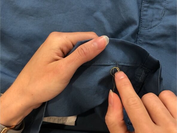

    • From the front side, pierce the seam one stitch length behind the point where the thread emerges, moving in the opposite direction of the stitching path.
    • Pull needle and thread through to the backside.

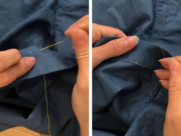

    • From the backside, pierce the seam two stitch lengths forward, moving in the direction of the stitching path.
    • Pull the needle and thread through to the front side.
    • Repeat steps 4 and 5 to create a continuous backstitch along the marked seam line.

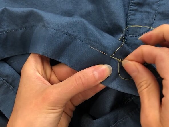

  6. Backstitch on a Loose Hem, Stitch in one movement: crwdns2935265:06crwdnd2935265:01crwdnd2935265:03crwdne2935265:0 Backstitch on a Loose Hem, Stitch in one movement: crwdns2935265:06crwdnd2935265:02crwdnd2935265:03crwdne2935265:0 Backstitch on a Loose Hem, Stitch in one movement: crwdns2935265:06crwdnd2935265:03crwdnd2935265:03crwdne2935265:0

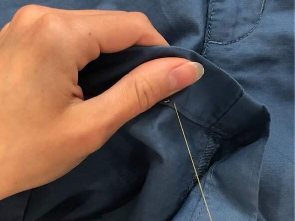

    • To backstitch without repeatedly flipping the fabric, insert the needle into the seam one stitch length behind the current position and guide it to exit one stitch length forward.
    • The working thread should lie in the middle of the needle's entry and exit points.
    • Pull the thread through to secure the stitch.
    • This method is quicker but more prone to tangling on the backside. Periodically check that the thread is pulling through smoothly.

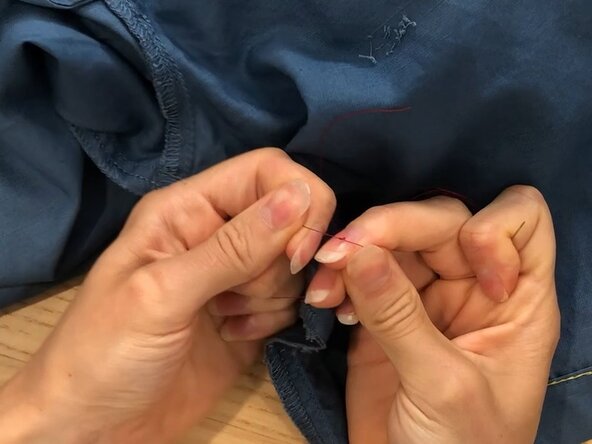

  7. Backstitch on a Loose Hem, Tie off the thread: crwdns2935265:07crwdnd2935265:01crwdnd2935265:03crwdne2935265:0 Backstitch on a Loose Hem, Tie off the thread: crwdns2935265:07crwdnd2935265:02crwdnd2935265:03crwdne2935265:0 Backstitch on a Loose Hem, Tie off the thread: crwdns2935265:07crwdnd2935265:03crwdnd2935265:03crwdne2935265:0
    • Continue until the original stitch has been overlapped by at least 1/2 inch (13 mm) and finish with the needle on the backside.
    • Without pulling the needle all the way through, begin making a small stitch on the backside of the fabric.
    • Wrap the working thread around the needle point three times.
    • Pull the needle through the fabric and loops of thread. The wrapped thread will create a knot that lies flush with the fabric.
    • For a more detailed explanation see Knot Thread to the Fabric (2 Ways).

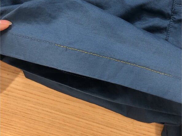

  9. Backstitch on a Loose Hem, Quality check: crwdns2935265:09crwdnd2935265:01crwdnd2935265:01crwdne2935265:0
    • Ensure the stitch securely closes the seam and can withstand tension.
    • Add additional lines of stitching if necessary.
