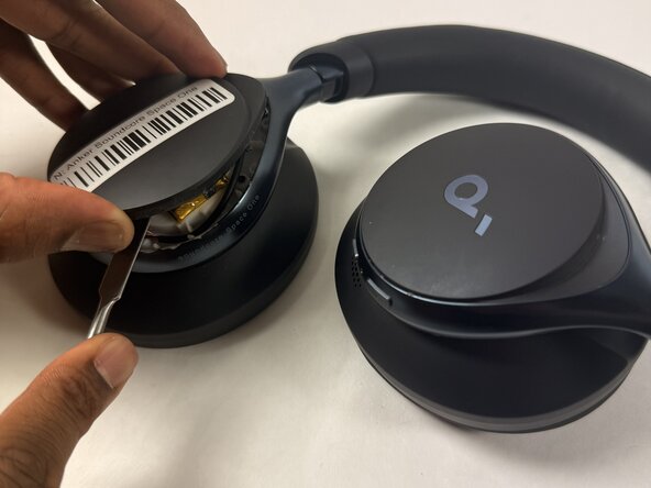

    • Flip over the device so you can see the Soundcore symbol on the back two ear pieces.
  2. Anker Soundcore Space One Battery Replacement: crwdns2935265:02crwdnd2935265:01crwdnd2935265:02crwdne2935265:0 Anker Soundcore Space One Battery Replacement: crwdns2935265:02crwdnd2935265:02crwdnd2935265:02crwdne2935265:0
    • Take a strong spudger (metal or plastic) and carefully insert it into the lining between the two back ear pieces.
    • Using a metal spudger (like the one pictured) can cut you if not used correctly. Please be mindful of where you insert it if you choose to use one
    • Removing the cover can take a couple of minutes. However, don't be aggressive while removing it, as you could damage the interior components under the back earpiece

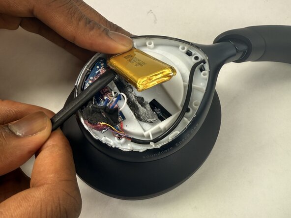

  3. Anker Soundcore Space One Battery Replacement: crwdns2935265:03crwdnd2935265:01crwdnd2935265:03crwdne2935265:0 Anker Soundcore Space One Battery Replacement: crwdns2935265:03crwdnd2935265:02crwdnd2935265:03crwdne2935265:0 Anker Soundcore Space One Battery Replacement: crwdns2935265:03crwdnd2935265:03crwdnd2935265:03crwdne2935265:0
    • Carefully remove the cover to reveal the battery.
    • Take a spudger and carefully lift the battery from the interior components.
    • Take care not to warp, bend, or puncture the battery.
    • The battery has a layer of adhesive under it. If necessary, use a hairdryer to lightly heat the battery to loosen the battery adhesive.

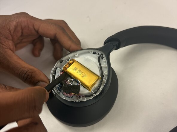

  4. Anker Soundcore Space One Battery Replacement: crwdns2935265:04crwdnd2935265:01crwdnd2935265:01crwdne2935265:0
    • Lift out the battery.
  5. Anker Soundcore Space One Battery Replacement: crwdns2935265:05crwdnd2935265:01crwdnd2935265:01crwdne2935265:0
    • Desolder the battery connections.
