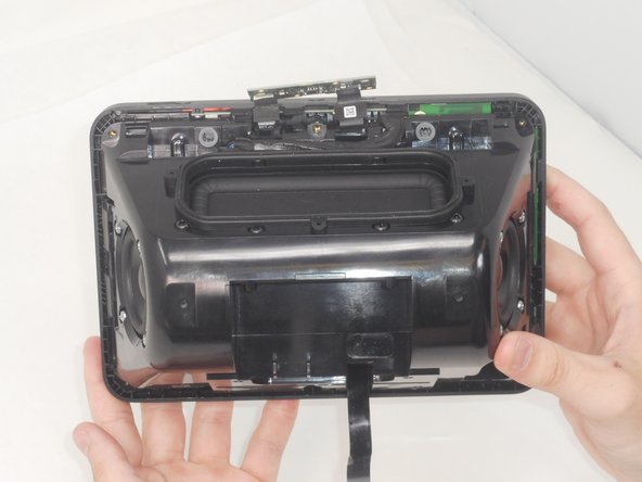

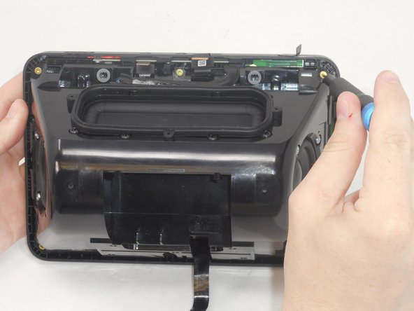

  5. Amazon Echo Show 8 2nd Generation Motherboard Replacement, Motherboard: crwdns2935265:05crwdnd2935265:01crwdnd2935265:03crwdne2935265:0 Amazon Echo Show 8 2nd Generation Motherboard Replacement, Motherboard: crwdns2935265:05crwdnd2935265:02crwdnd2935265:03crwdne2935265:0 Amazon Echo Show 8 2nd Generation Motherboard Replacement, Motherboard: crwdns2935265:05crwdnd2935265:03crwdnd2935265:03crwdne2935265:0
    • Use a T6 Torx screwdriver to remove the six 7.6 mm screws that secure the speaker housing to the display assembly.
    • There is a screw that is not pictured in the center of the bottom two screws.

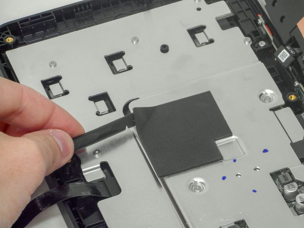

  6. Amazon Echo Show 8 2nd Generation Motherboard Replacement: crwdns2935265:06crwdnd2935265:01crwdnd2935265:03crwdne2935265:0 Amazon Echo Show 8 2nd Generation Motherboard Replacement: crwdns2935265:06crwdnd2935265:02crwdnd2935265:03crwdne2935265:0 Amazon Echo Show 8 2nd Generation Motherboard Replacement: crwdns2935265:06crwdnd2935265:03crwdnd2935265:03crwdne2935265:0
    • Open the device and place it on a flat surface.
    • There is a cable connecting the speaker housing to the display. Be careful when separating the two parts to prevent damaging the connector.
    • Use a rubber spudger to remove the foam mat at the center of the silver plate on the device and place it to the side.

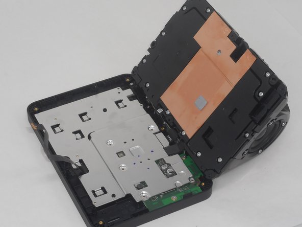

  7. Amazon Echo Show 8 2nd Generation Motherboard Replacement: crwdns2935265:07crwdnd2935265:01crwdnd2935265:02crwdne2935265:0 Amazon Echo Show 8 2nd Generation Motherboard Replacement: crwdns2935265:07crwdnd2935265:02crwdnd2935265:02crwdne2935265:0
    • Use a T6 Torx screwdriver to remove the twelve 6 mm screws that secure the silver bracket.
  8. Amazon Echo Show 8 2nd Generation Motherboard Replacement: crwdns2935265:08crwdnd2935265:01crwdnd2935265:02crwdne2935265:0 Amazon Echo Show 8 2nd Generation Motherboard Replacement: crwdns2935265:08crwdnd2935265:02crwdnd2935265:02crwdne2935265:0
    • Use a plastic spudger to lift the silver bracket slightly.
    • Lift the silver bracket up and out of the chassis.

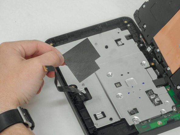

  9. Amazon Echo Show 8 2nd Generation Motherboard Replacement: crwdns2935265:09crwdnd2935265:01crwdnd2935265:03crwdne2935265:0 Amazon Echo Show 8 2nd Generation Motherboard Replacement: crwdns2935265:09crwdnd2935265:02crwdnd2935265:03crwdne2935265:0 Amazon Echo Show 8 2nd Generation Motherboard Replacement: crwdns2935265:09crwdnd2935265:03crwdnd2935265:03crwdne2935265:0

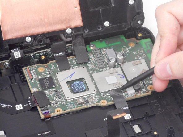

    • Use a spudger to remove the four foam covers on the cables.

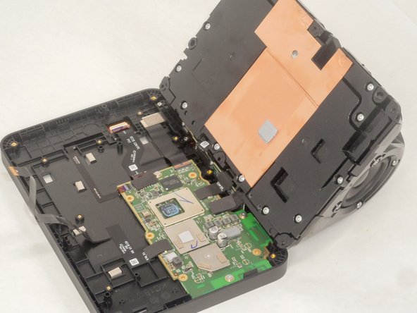

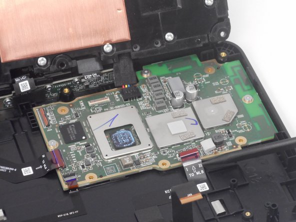

  10. Amazon Echo Show 8 2nd Generation Motherboard Replacement: crwdns2935265:010crwdnd2935265:01crwdnd2935265:02crwdne2935265:0 Amazon Echo Show 8 2nd Generation Motherboard Replacement: crwdns2935265:010crwdnd2935265:02crwdnd2935265:02crwdne2935265:0
    • Use the pointed end of a spudger to flip up the both of the ZIF locking flaps. Gently pull both of the cables out of their respective ports.
    • Flip up the locking flap OPPOSITE of the cable, i.e., the other side from the previous cables.
    • Remove the speaker connector by pushing it away from the motherboard with the pointed end of a spudger.

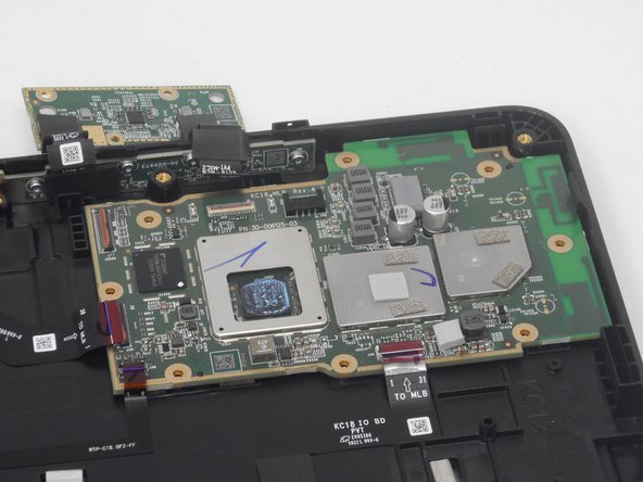

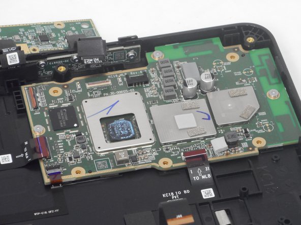

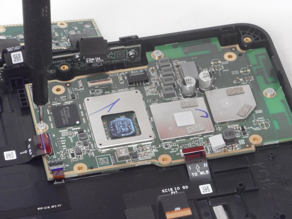

  11. Amazon Echo Show 8 2nd Generation Motherboard Replacement: crwdns2935265:011crwdnd2935265:01crwdnd2935265:03crwdne2935265:0 Amazon Echo Show 8 2nd Generation Motherboard Replacement: crwdns2935265:011crwdnd2935265:02crwdnd2935265:03crwdne2935265:0 Amazon Echo Show 8 2nd Generation Motherboard Replacement: crwdns2935265:011crwdnd2935265:03crwdnd2935265:03crwdne2935265:0
    • Use a T6 Torx screwdriver to remove the eight 5.2 mm screws that secure the motherboard.

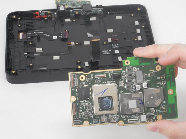

  12. Amazon Echo Show 8 2nd Generation Motherboard Replacement: crwdns2935265:012crwdnd2935265:01crwdnd2935265:02crwdne2935265:0 Amazon Echo Show 8 2nd Generation Motherboard Replacement: crwdns2935265:012crwdnd2935265:02crwdnd2935265:02crwdne2935265:0
    • Gently lift the motherboard up and out of the chassis.
