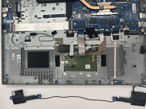

  5. Acer Aspire Go 15 AG15-31P-3947 Motherboard Replacement, Speakers: crwdns2935265:05crwdnd2935265:01crwdnd2935265:02crwdne2935265:0 Acer Aspire Go 15 AG15-31P-3947 Motherboard Replacement, Speakers: crwdns2935265:05crwdnd2935265:02crwdnd2935265:02crwdne2935265:0
    • To disconnect the speaker cable, use the point of a spudger to push on alternating sides of the connector to "walk" it out of its socket.
    • Don't pull on the cables.

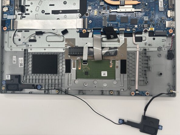

  6. Acer Aspire Go 15 AG15-31P-3947 Motherboard Replacement: crwdns2935265:06crwdnd2935265:01crwdnd2935265:03crwdne2935265:0 Acer Aspire Go 15 AG15-31P-3947 Motherboard Replacement: crwdns2935265:06crwdnd2935265:02crwdnd2935265:03crwdne2935265:0 Acer Aspire Go 15 AG15-31P-3947 Motherboard Replacement: crwdns2935265:06crwdnd2935265:03crwdnd2935265:03crwdne2935265:0
    • Gently remove the speaker wire from routing guides.
    • The wire may also be attached to the chassis with adhesive.
    • Remove the speakers and wire that connects them from the laptop.

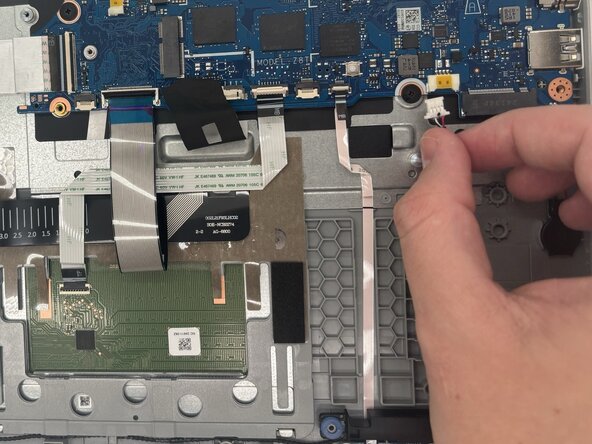

    • Use a spudger or a clean fingernail to flip up the locking flap on the four ZIF connectors—this is the unlocked position.
    • Use tweezers or your fingers to gently pull each cable out of its socket.
    • Try pushing on alternating sides of the CMOS battery connector with a spudger to disconnect it from the socket.
    • If that doesn't work, use a pair of tweezers to firmly grip the sides of the connector and pull straight away from the socket. Hold the tweezers closer to the connector to get a better grip.
    • To disconnect the display connector, first, gently push the tip of a spudger under the metal buckle to unclip it, then swing it over the socket.
    • Next, hold the buckle and cable together and gently pull the connector straight out of its socket.
    • Use the point of a spudger to push on alternating sides of the power connector to "walk" it out of its socket.
    • Don't pull on the wires or you risk damaging the connector and device.

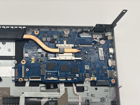

  10. Acer Aspire Go 15 AG15-31P-3947 Motherboard Replacement: crwdns2935265:010crwdnd2935265:01crwdnd2935265:02crwdne2935265:0 Acer Aspire Go 15 AG15-31P-3947 Motherboard Replacement: crwdns2935265:010crwdnd2935265:02crwdnd2935265:02crwdne2935265:0
    • Use a Phillips #1 screwdriver to remove the four screws from the hinge.
    • Lift the hinge to allow the motherboard to be removed.

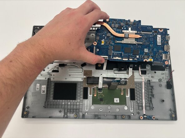

  11. Acer Aspire Go 15 AG15-31P-3947 Motherboard Replacement: crwdns2935265:011crwdnd2935265:01crwdnd2935265:02crwdne2935265:0 Acer Aspire Go 15 AG15-31P-3947 Motherboard Replacement: crwdns2935265:011crwdnd2935265:02crwdnd2935265:02crwdne2935265:0
    • Use a Phillips #1 screwdriver to remove the four screws securing the motherboard to the chassis.
    • If your replacement board does not come with a heat sink, remove the three screws in descending order of the inscribed numbers on the heat sink.
    • If you aren't replacing the heat sink, loosen the screws before removing the motherboard.
    • Lift the motherboard from the laptop.
