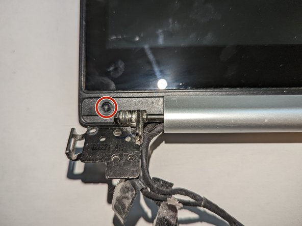

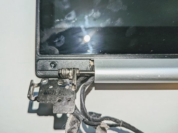

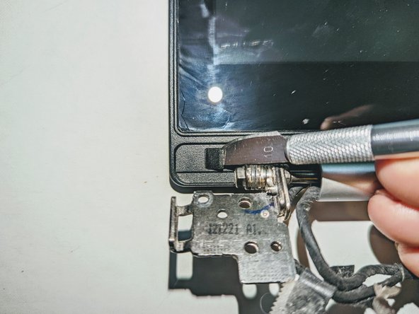

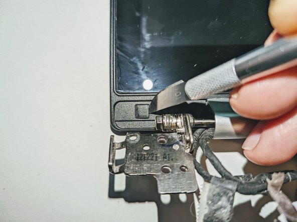

  14. ASUS VivoBook S400C LCD / Touch Screen Assembly Replacement, Remove the Display Retaining Screws: crwdns2935265:014crwdnd2935265:01crwdnd2935265:03crwdne2935265:0 ASUS VivoBook S400C LCD / Touch Screen Assembly Replacement, Remove the Display Retaining Screws: crwdns2935265:014crwdnd2935265:02crwdnd2935265:03crwdne2935265:0 ASUS VivoBook S400C LCD / Touch Screen Assembly Replacement, Remove the Display Retaining Screws: crwdns2935265:014crwdnd2935265:03crwdnd2935265:03crwdne2935265:0
    • There are two black square plastic tabs covering the retaining screws. The tabs are fixed in place with light adhesive.
    • Using a thin blade, pry off the tabs covering the screws.
  15. ASUS VivoBook S400C LCD / Touch Screen Assembly Replacement: crwdns2935265:015crwdnd2935265:01crwdnd2935265:02crwdne2935265:0 ASUS VivoBook S400C LCD / Touch Screen Assembly Replacement: crwdns2935265:015crwdnd2935265:02crwdnd2935265:02crwdne2935265:0
    • With a Phillips #0 screwdriver, remove the two 3.8 mm screws holding the bezel in place.

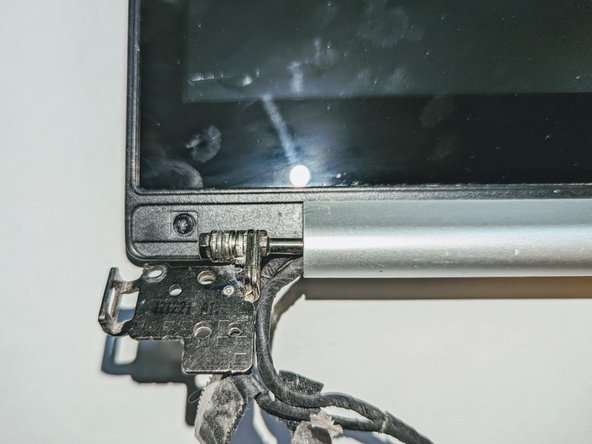

  16. ASUS VivoBook S400C LCD / Touch Screen Assembly Replacement, Remove the Hinge Cover: crwdns2935265:016crwdnd2935265:01crwdnd2935265:03crwdne2935265:0 ASUS VivoBook S400C LCD / Touch Screen Assembly Replacement, Remove the Hinge Cover: crwdns2935265:016crwdnd2935265:02crwdnd2935265:03crwdne2935265:0 ASUS VivoBook S400C LCD / Touch Screen Assembly Replacement, Remove the Hinge Cover: crwdns2935265:016crwdnd2935265:03crwdnd2935265:03crwdne2935265:0
    • Grasp the hinge cover and slide it to the right. It will only move about 3mm (1/8 inch).
  17. ASUS VivoBook S400C LCD / Touch Screen Assembly Replacement: crwdns2935265:017crwdnd2935265:01crwdnd2935265:02crwdne2935265:0 ASUS VivoBook S400C LCD / Touch Screen Assembly Replacement: crwdns2935265:017crwdnd2935265:02crwdnd2935265:02crwdne2935265:0
    • Tilt the hinge cover toward you and pull up to remove it.
    • It may catch on the parts it's covering as you remove it. If that happens, just wiggle it around until it comes free.
    • No force should be needed to remove it. You do not have to pry on it to take it out.

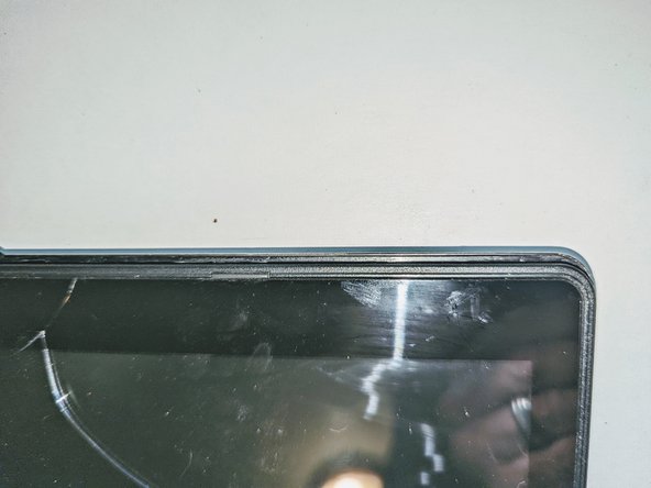

  18. ASUS VivoBook S400C LCD / Touch Screen Assembly Replacement, Release the Display Panel: crwdns2935265:018crwdnd2935265:01crwdnd2935265:02crwdne2935265:0 ASUS VivoBook S400C LCD / Touch Screen Assembly Replacement, Release the Display Panel: crwdns2935265:018crwdnd2935265:02crwdnd2935265:02crwdne2935265:0
    • Slide the screen down to release the catches holding it in place.
    • It will only move about 3mm (1/8 inch) and will stop when it has moved sufficiently.
  19. ASUS VivoBook S400C LCD / Touch Screen Assembly Replacement: crwdns2935265:019crwdnd2935265:01crwdnd2935265:03crwdne2935265:0 ASUS VivoBook S400C LCD / Touch Screen Assembly Replacement: crwdns2935265:019crwdnd2935265:02crwdnd2935265:03crwdne2935265:0 ASUS VivoBook S400C LCD / Touch Screen Assembly Replacement: crwdns2935265:019crwdnd2935265:03crwdnd2935265:03crwdne2935265:0
    • Lift up on the now-exposed bottom edge of the screen. Go around the edges, lifting it away from the housing. If it is still caught anywhere, remember to slide it down to free it.
    • Again, no force is needed. You do not have to pry on it to take it out. Doing so will damage the housing and/or the bezel.
    • Slide the screen out from under the hinges and remove it.

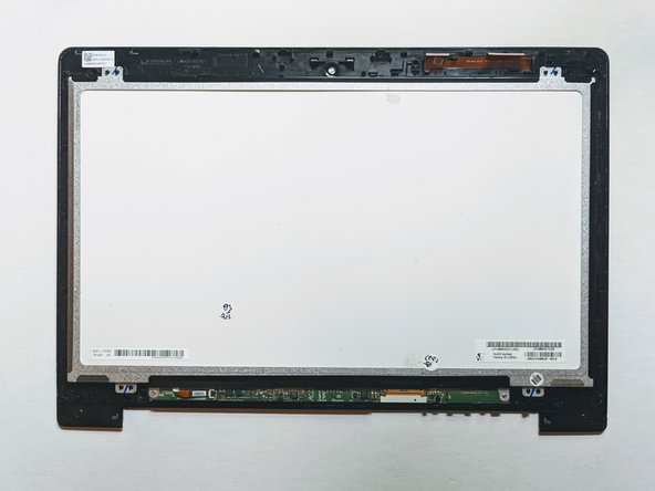

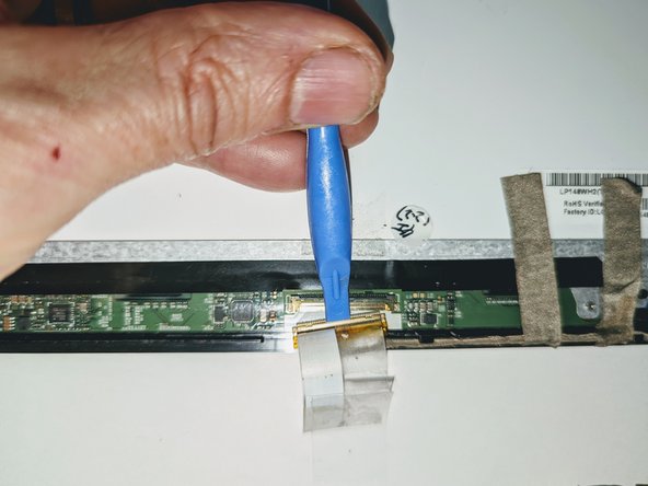

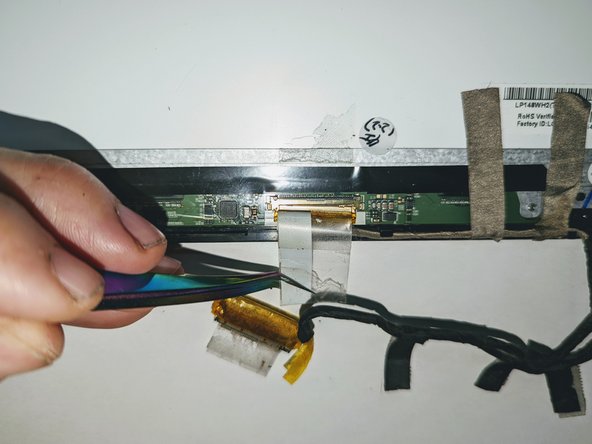

  20. ASUS VivoBook S400C LCD / Touch Screen Assembly Replacement, Disconnect the LCD Cable: crwdns2935265:020crwdnd2935265:01crwdnd2935265:02crwdne2935265:0 ASUS VivoBook S400C LCD / Touch Screen Assembly Replacement, Disconnect the LCD Cable: crwdns2935265:020crwdnd2935265:02crwdnd2935265:02crwdne2935265:0
    • Flip the touch screen assembly over and peel the clear tape covering the LCD connector off the LCD panel.
  21. ASUS VivoBook S400C LCD / Touch Screen Assembly Replacement: crwdns2935265:021crwdnd2935265:01crwdnd2935265:02crwdne2935265:0 ASUS VivoBook S400C LCD / Touch Screen Assembly Replacement: crwdns2935265:021crwdnd2935265:02crwdnd2935265:02crwdne2935265:0
    • Using a spudger, slide the connector out in the direction of the bottom of the screen.

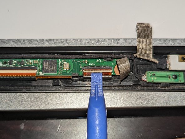

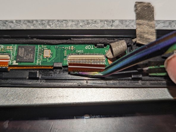

  22. ASUS VivoBook S400C LCD / Touch Screen Assembly Replacement, Dismount the Touchscreen Controller Board: crwdns2935265:022crwdnd2935265:01crwdnd2935265:03crwdne2935265:0 ASUS VivoBook S400C LCD / Touch Screen Assembly Replacement, Dismount the Touchscreen Controller Board: crwdns2935265:022crwdnd2935265:02crwdnd2935265:03crwdne2935265:0 ASUS VivoBook S400C LCD / Touch Screen Assembly Replacement, Dismount the Touchscreen Controller Board: crwdns2935265:022crwdnd2935265:03crwdnd2935265:03crwdne2935265:0
    • The next few steps are easier if you rotate the display so the top of the screen is facing you.
    • Peel off the tape providing a ground point to the LCD frame.

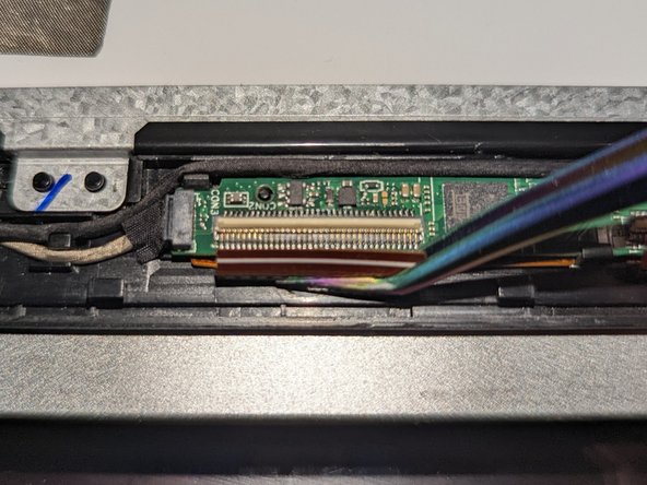

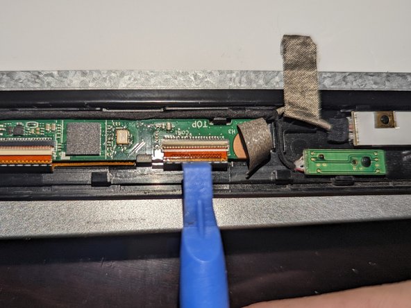

    • Use the flat end of a spudger to flip up the latch on the right connector.
  23. ASUS VivoBook S400C LCD / Touch Screen Assembly Replacement: crwdns2935265:023crwdnd2935265:01crwdnd2935265:02crwdne2935265:0 ASUS VivoBook S400C LCD / Touch Screen Assembly Replacement: crwdns2935265:023crwdnd2935265:02crwdnd2935265:02crwdne2935265:0
    • Use the flat end of a spudger to flip up the latch on the left connector.
  24. ASUS VivoBook S400C LCD / Touch Screen Assembly Replacement: crwdns2935265:024crwdnd2935265:01crwdnd2935265:02crwdne2935265:0 ASUS VivoBook S400C LCD / Touch Screen Assembly Replacement: crwdns2935265:024crwdnd2935265:02crwdnd2935265:02crwdne2935265:0
    • Use fine tip tweezers to slide the right ribbon cable out of the connector.
  25. ASUS VivoBook S400C LCD / Touch Screen Assembly Replacement: crwdns2935265:025crwdnd2935265:01crwdnd2935265:02crwdne2935265:0 ASUS VivoBook S400C LCD / Touch Screen Assembly Replacement: crwdns2935265:025crwdnd2935265:02crwdnd2935265:02crwdne2935265:0
    • Use fine tip tweezers to slide the left ribbon cable out of the connector.

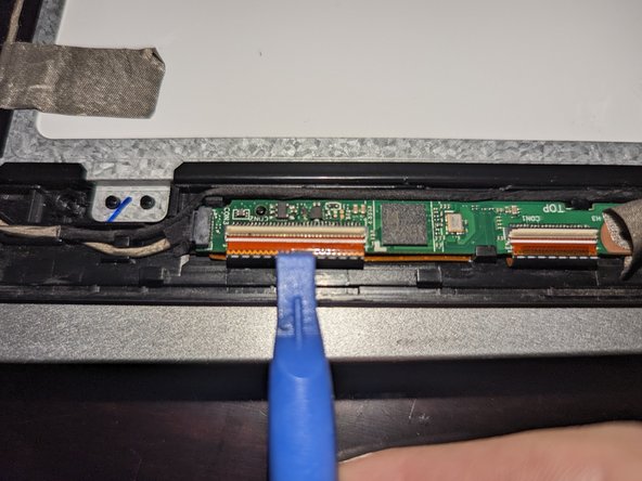

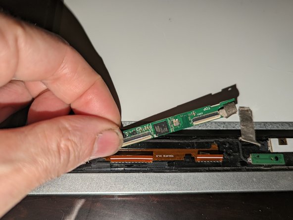

  26. ASUS VivoBook S400C LCD / Touch Screen Assembly Replacement: crwdns2935265:026crwdnd2935265:01crwdnd2935265:03crwdne2935265:0 ASUS VivoBook S400C LCD / Touch Screen Assembly Replacement: crwdns2935265:026crwdnd2935265:02crwdnd2935265:03crwdne2935265:0 ASUS VivoBook S400C LCD / Touch Screen Assembly Replacement: crwdns2935265:026crwdnd2935265:03crwdnd2935265:03crwdne2935265:0
    • The touchscreen board is secured to the bezel with two latches on the far side and a plastic hook on the near side.
    • Use a spudger to open the right latch while gently prying up with an opening tool or a fingernail.
    • Use a spudger to open the left latch while gently prying up with an opening tool or a fingernail.
  27. ASUS VivoBook S400C LCD / Touch Screen Assembly Replacement: crwdns2935265:027crwdnd2935265:01crwdnd2935265:02crwdne2935265:0 ASUS VivoBook S400C LCD / Touch Screen Assembly Replacement: crwdns2935265:027crwdnd2935265:02crwdnd2935265:02crwdne2935265:0
    • Rotate the board toward you while sliding it forward slightly to free it from the bottom hook.
    • Lift the board away from the bezel and move it aside.

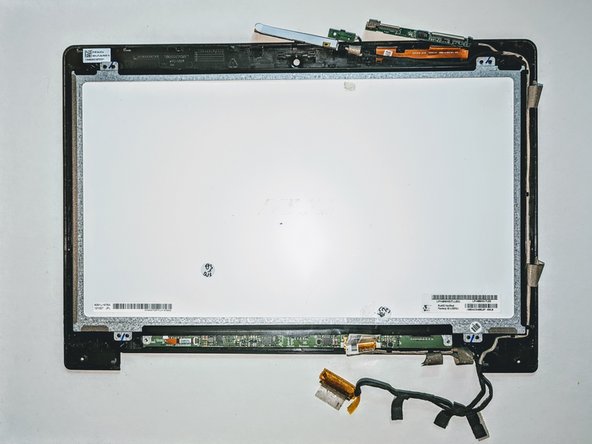

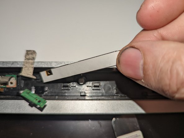

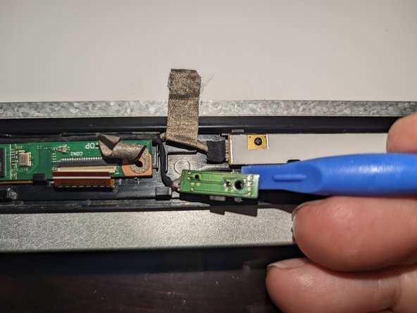

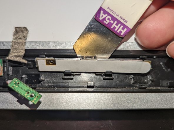

  28. ASUS VivoBook S400C LCD / Touch Screen Assembly Replacement, Dismount the Microphone Board: crwdns2935265:028crwdnd2935265:01crwdnd2935265:02crwdne2935265:0 ASUS VivoBook S400C LCD / Touch Screen Assembly Replacement, Dismount the Microphone Board: crwdns2935265:028crwdnd2935265:02crwdnd2935265:02crwdne2935265:0
    • The microphone daughterboard is held in place by being pressed down onto a plastic pin.
    • Pry it up off the retaining pin with a plastic spudger.

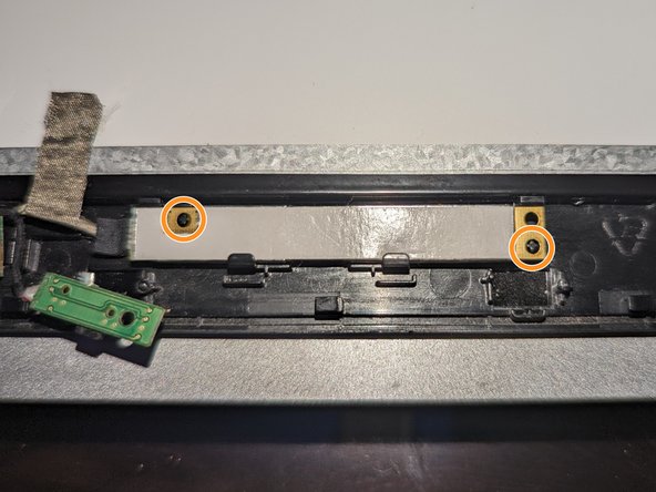

  29. ASUS VivoBook S400C LCD / Touch Screen Assembly Replacement, Dismount the Camera Board: crwdns2935265:029crwdnd2935265:01crwdnd2935265:02crwdne2935265:0 ASUS VivoBook S400C LCD / Touch Screen Assembly Replacement, Dismount the Camera Board: crwdns2935265:029crwdnd2935265:02crwdnd2935265:02crwdne2935265:0
    • The camera daughterboard is held in place with two latches along the top of the board and two hooks on the bottom.
    • It is seated on two plastic guide pins as well.
    • Be sure the board is fully seated on the guide pins when reassembling.
  30. ASUS VivoBook S400C LCD / Touch Screen Assembly Replacement: crwdns2935265:030crwdnd2935265:01crwdnd2935265:03crwdne2935265:0 ASUS VivoBook S400C LCD / Touch Screen Assembly Replacement: crwdns2935265:030crwdnd2935265:02crwdnd2935265:03crwdne2935265:0 ASUS VivoBook S400C LCD / Touch Screen Assembly Replacement: crwdns2935265:030crwdnd2935265:03crwdnd2935265:03crwdne2935265:0
    • Slide a thin pry tool between the top of the camera board and the lip of the bezel.
    • Gently pry up on the board to free it from the latches and the guide pins it sits on.
    • Lift it up and away from the bezel and set it to the side.

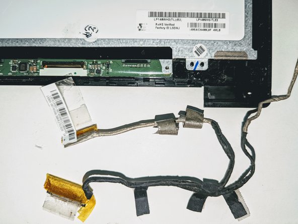

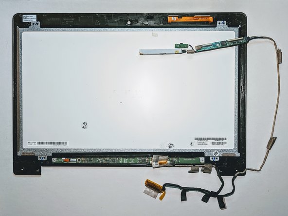

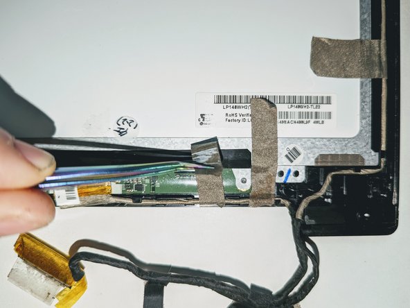

  31. ASUS VivoBook S400C LCD / Touch Screen Assembly Replacement, Remove the Wiring Harness: crwdns2935265:031crwdnd2935265:01crwdnd2935265:03crwdne2935265:0 ASUS VivoBook S400C LCD / Touch Screen Assembly Replacement, Remove the Wiring Harness: crwdns2935265:031crwdnd2935265:02crwdnd2935265:03crwdne2935265:0 ASUS VivoBook S400C LCD / Touch Screen Assembly Replacement, Remove the Wiring Harness: crwdns2935265:031crwdnd2935265:03crwdnd2935265:03crwdne2935265:0
    • Carefully remove the five pieces of conductive tape securing the cables to the LCD frame.
  32. ASUS VivoBook S400C LCD / Touch Screen Assembly Replacement: crwdns2935265:032crwdnd2935265:01crwdnd2935265:03crwdne2935265:0 ASUS VivoBook S400C LCD / Touch Screen Assembly Replacement: crwdns2935265:032crwdnd2935265:02crwdnd2935265:03crwdne2935265:0 ASUS VivoBook S400C LCD / Touch Screen Assembly Replacement: crwdns2935265:032crwdnd2935265:03crwdnd2935265:03crwdne2935265:0
    • Deroute the wiring to the daughterboards from the front bezel.

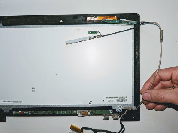

  33. ASUS VivoBook S400C LCD / Touch Screen Assembly Replacement: crwdns2935265:033crwdnd2935265:01crwdnd2935265:03crwdne2935265:0 ASUS VivoBook S400C LCD / Touch Screen Assembly Replacement: crwdns2935265:033crwdnd2935265:02crwdnd2935265:03crwdne2935265:0 ASUS VivoBook S400C LCD / Touch Screen Assembly Replacement: crwdns2935265:033crwdnd2935265:03crwdnd2935265:03crwdne2935265:0
    • Deroute the LCD cable from the display.
    • The LCD / digitizer assembly is now free.
