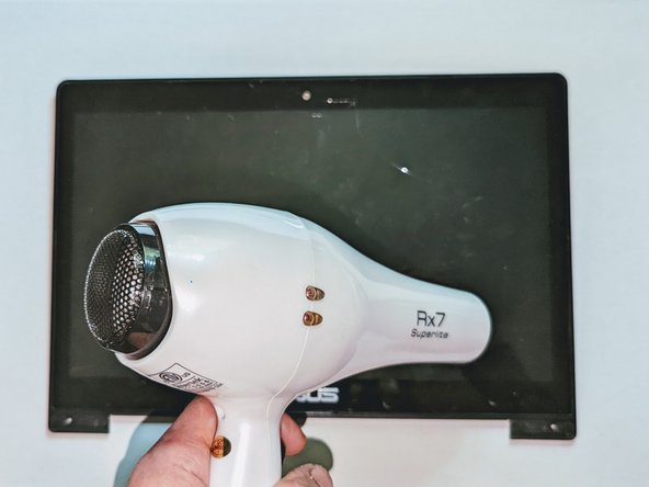

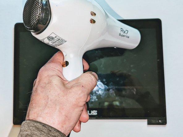

  34. ASUS VivoBook S400C LCD Replacement, Separate the LCD from the Display: crwdns2935265:034crwdnd2935265:01crwdnd2935265:03crwdne2935265:0 ASUS VivoBook S400C LCD Replacement, Separate the LCD from the Display: crwdns2935265:034crwdnd2935265:02crwdnd2935265:03crwdne2935265:0 ASUS VivoBook S400C LCD Replacement, Separate the LCD from the Display: crwdns2935265:034crwdnd2935265:03crwdnd2935265:03crwdne2935265:0
    • Heat the front edges of the touch screen with an iOpener, a heat gun or a hair dryer to loosen the adhesive securing the LCD to the digitizer.

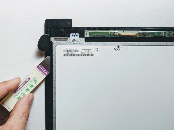

  35. ASUS VivoBook S400C LCD Replacement: crwdns2935265:035crwdnd2935265:01crwdnd2935265:03crwdne2935265:0 ASUS VivoBook S400C LCD Replacement: crwdns2935265:035crwdnd2935265:02crwdnd2935265:03crwdne2935265:0 ASUS VivoBook S400C LCD Replacement: crwdns2935265:035crwdnd2935265:03crwdnd2935265:03crwdne2935265:0
    • Using a flat metal opening tool, carefully pry up the LCD, inserting opening picks as you go to prevent the display from re-adhering to the digitizer.
    • If you encounter significant resistance, reheat the section you are working on.
    • Start with the top edge of the display.

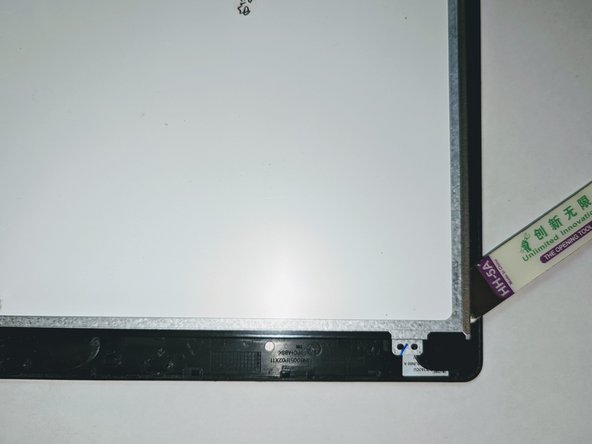

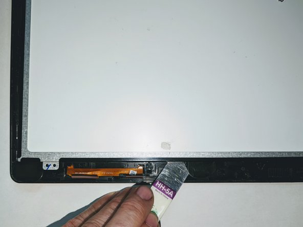

  36. ASUS VivoBook S400C LCD Replacement: crwdns2935265:036crwdnd2935265:01crwdnd2935265:03crwdne2935265:0 ASUS VivoBook S400C LCD Replacement: crwdns2935265:036crwdnd2935265:02crwdnd2935265:03crwdne2935265:0 ASUS VivoBook S400C LCD Replacement: crwdns2935265:036crwdnd2935265:03crwdnd2935265:03crwdne2935265:0
    • Proceed down the sides of the display and place picks at the bottom corners.
    • Do not attempt to slide an opener under the circuit board along the bottom of the display; you may damage the delicate electrical connectors.

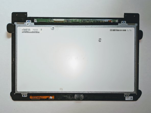

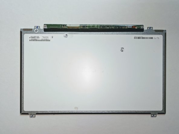

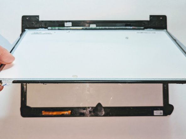

  37. ASUS VivoBook S400C LCD Replacement: crwdns2935265:037crwdnd2935265:01crwdnd2935265:03crwdne2935265:0 ASUS VivoBook S400C LCD Replacement: crwdns2935265:037crwdnd2935265:02crwdnd2935265:03crwdne2935265:0 ASUS VivoBook S400C LCD Replacement: crwdns2935265:037crwdnd2935265:03crwdnd2935265:03crwdne2935265:0
    • Carefully lift the top edge of the LCD away from the frame.
    • The remaining adhesive on the bottom of the glass will peel off as you continue to lift the LCD.
    • The LCD is now free from the display.
