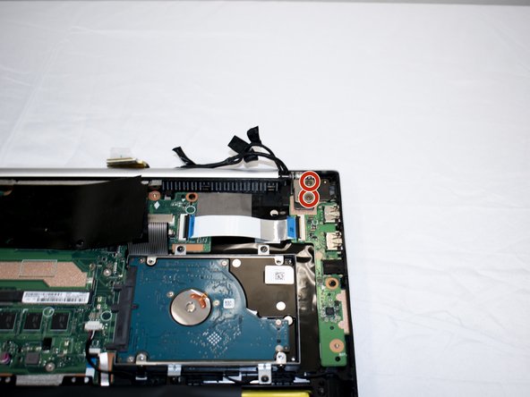

    • Using a Phillips #0 screwdriver, remove the four 6 mm hinge screws.

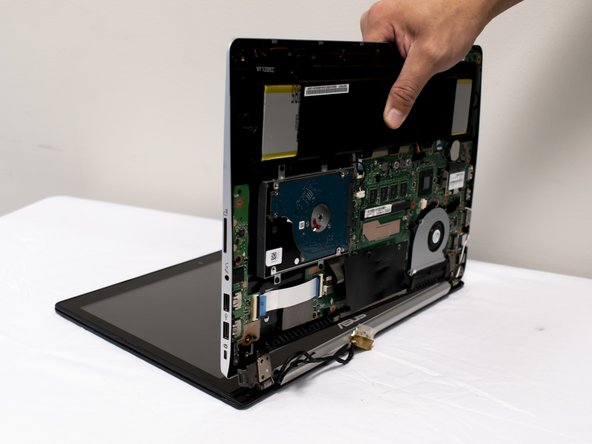

    • Lift the bottom (keyboard) portion of the laptop up holding closely to the hinge. Keep rotating along the hinge until the bottom portion becomes detached.
    • After rotating open to about a 90 degree angle, lift the bottom portion outwards.

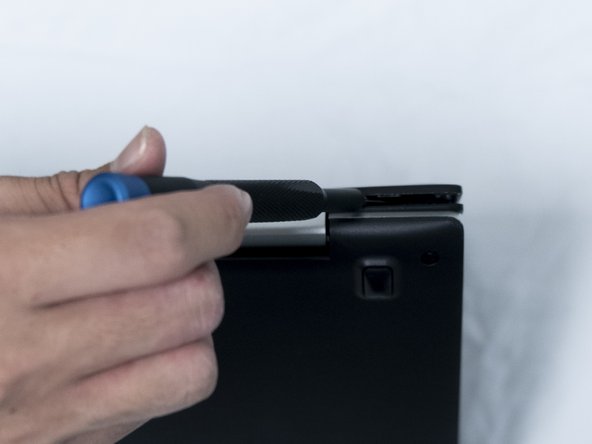

    • Using a #3 flathead screwdriver, pull the black tabs covering the screws.

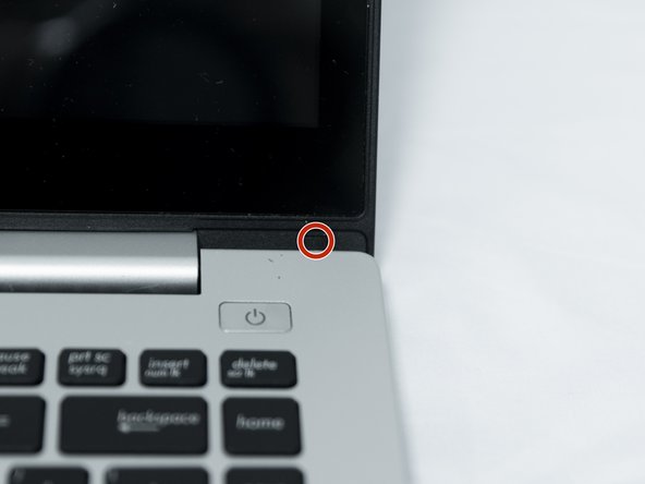

    • With a Phillips #0 screwdriver, remove the two 3.8 mm screws holding the bezel in place.

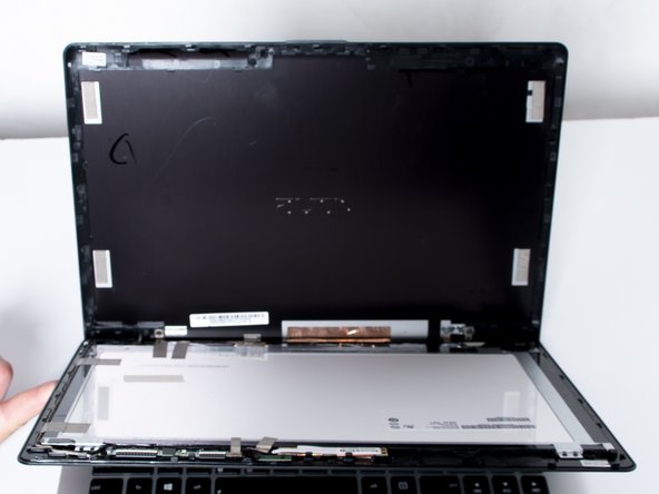

    • Use a plastic opening tool to go around the edges and release the bezel panel along the sides, switching to a #3 flathead screwdriver along the bottom edges.

I would advise you not to use this guide. Specifically, following step 15 will result in damage to your display bezel and/or the display housing. The LCD/touch screen assembly slides down to release it from the latches holding it in place. If you simply pry it apart without sliding it down, you will break the retainers that hold it together.
