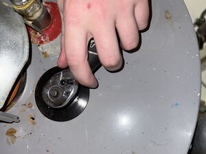

Annual Cleaning: Once a year, give your water heater a thorough clean-out. This means draining and flushing the tank to get rid of any sediment build-up. Here's how to do it:
  1. Preparation: Start by turning off the electricity to your water heater. Then, shut off the water supply.
  2. Draining the Tank: Attach a garden hose to the draincock (the tap at the bottom of your tank) and open it up. To help the tank drain faster, open a hot water faucet somewhere in your house.
  3. Refilling the Tank: After draining, close the draincock and turn the water supply back on. Keep a hot water faucet open while the tank refills. This allows any trapped air to escape. You'll know the tank is full when water flows normally from the open faucet.
  4. Final Steps: Once the tank is full and there's no more air coming out, you can close the faucet. Don't forget to go around and open other hot water faucets briefly to clear any air from those lines too. Finally, you can turn the electricity back on to your water heater.
