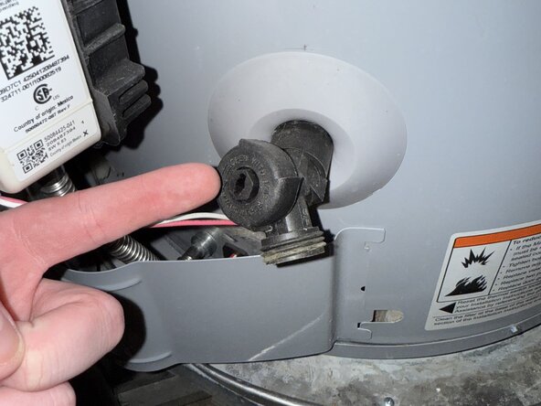

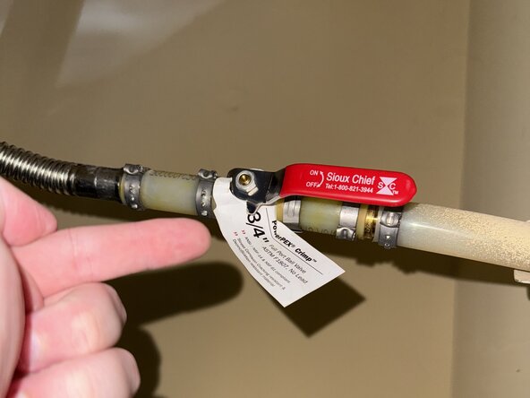

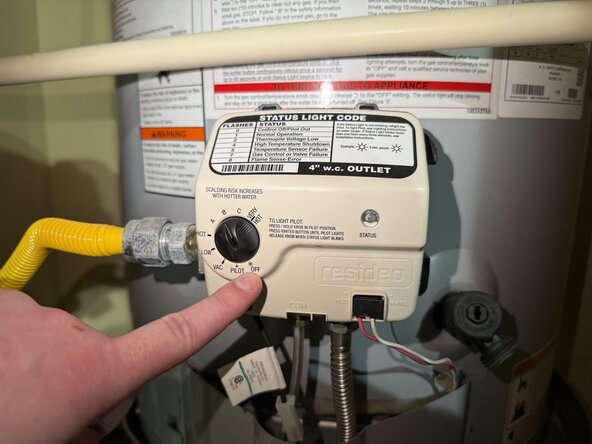

    • Turn off the power and water supply to the water heater tank.
  2. AO Smith 100 50-Gallon Water Heater Sacrificial Anode Rod Replacement: crwdns2935265:02crwdnd2935265:01crwdnd2935265:02crwdne2935265:0 AO Smith 100 50-Gallon Water Heater Sacrificial Anode Rod Replacement: crwdns2935265:02crwdnd2935265:02crwdnd2935265:02crwdne2935265:0

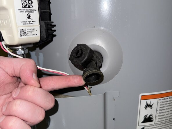

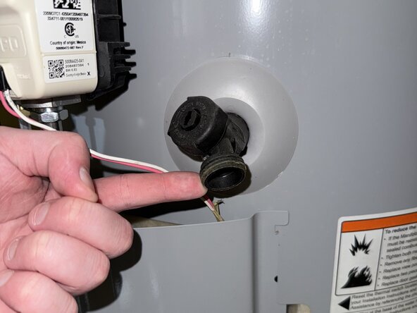

    • Drain the water heater tank using a flathead screwdriver (optional but recommended).
  3. AO Smith 100 50-Gallon Water Heater Sacrificial Anode Rod Replacement: crwdns2935265:03crwdnd2935265:01crwdnd2935265:02crwdne2935265:0 AO Smith 100 50-Gallon Water Heater Sacrificial Anode Rod Replacement: crwdns2935265:03crwdnd2935265:02crwdnd2935265:02crwdne2935265:0

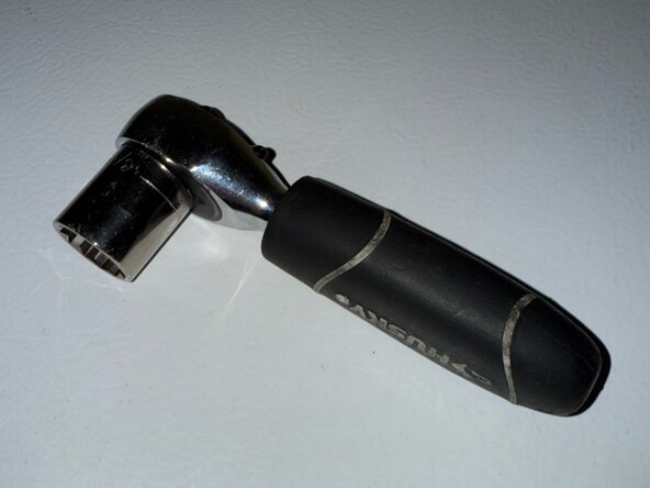

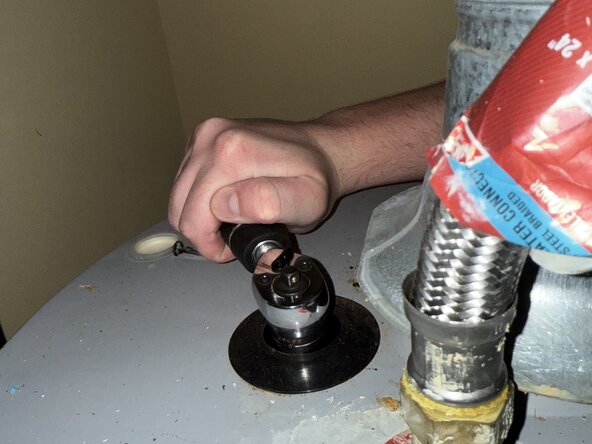

    • Locate the sacrificial anode rod, and loosen and remove the old anode rod using the socket wrench.
  4. AO Smith 100 50-Gallon Water Heater Sacrificial Anode Rod Replacement: crwdns2935265:04crwdnd2935265:01crwdnd2935265:02crwdne2935265:0 AO Smith 100 50-Gallon Water Heater Sacrificial Anode Rod Replacement: crwdns2935265:04crwdnd2935265:02crwdnd2935265:02crwdne2935265:0
    • Use the socket wrench to loosen the old sacrificial anode rod, and physically extract it from the tank.
    • To install the new sacrificial anode rod, lower it into the tank and tighten using the socket wrench, securing its place.
  5. AO Smith 100 50-Gallon Water Heater Sacrificial Anode Rod Replacement: crwdns2935265:05crwdnd2935265:01crwdnd2935265:02crwdne2935265:0 AO Smith 100 50-Gallon Water Heater Sacrificial Anode Rod Replacement: crwdns2935265:05crwdnd2935265:02crwdnd2935265:02crwdne2935265:0
    • Close the drain valve and refill the tank (reverse the steps from draining the tank).
  6. AO Smith 100 50-Gallon Water Heater Sacrificial Anode Rod Replacement: crwdns2935265:06crwdnd2935265:01crwdnd2935265:01crwdne2935265:0
    • Turn on the power or gas supply and check for leaks (reverse the steps from turning off the tank).
