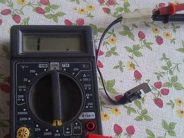

    • PROBLEM: faulty micro switch. FIX: Disconnect power mains!!! remove the switch, check the conductivity with a multimeter.
  2. Themotop Combination Central Heating and Boiler Micro Switch Maintainence: crwdns2935265:02crwdnd2935265:01crwdnd2935265:03crwdne2935265:0 Themotop Combination Central Heating and Boiler Micro Switch Maintainence: crwdns2935265:02crwdnd2935265:02crwdnd2935265:03crwdne2935265:0 Themotop Combination Central Heating and Boiler Micro Switch Maintainence: crwdns2935265:02crwdnd2935265:03crwdnd2935265:03crwdne2935265:0
    • FIX: Disconnect power mains!!! remove the switch, check the conductivity with a multimeter. if the switch is faulty remove the green seal and drip some contact cleaner (alcohol) into the switch. Check the conductivity again. Let it dry upside down in a hot dry place.
  3. Themotop Combination Central Heating and Boiler Micro Switch Maintainence: crwdns2935265:03crwdnd2935265:01crwdnd2935265:02crwdne2935265:0 Themotop Combination Central Heating and Boiler Micro Switch Maintainence: crwdns2935265:03crwdnd2935265:02crwdnd2935265:02crwdne2935265:0
    • check the conductivity with a multimeter. if the switch is faulty remove the green seal and drip some alcohol into the switch. Check the conductivity again. Let it dry upside down in a hot dry place. Buy a new one if it's still bad.
  4. Themotop Combination Central Heating and Boiler Micro Switch Maintainence: crwdns2935265:04crwdnd2935265:01crwdnd2935265:01crwdne2935265:0
    • Put it back, reconnect mains but keep an eye on the gas flame that might turn on without the switch is being pressed (if it is so the switch is not dry inside). Say thanks to me ( atosmaximus (at) gmail.com :-)
