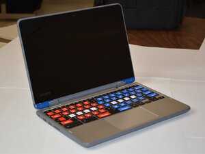

Identification
The Lenovo Flex 11 Chromebook looks like a one color dark gray 2-in-1 laptop with a durable plastic build, rubber trim around the lid, and two 360-degree hinges.
When opening the Chromebook, you can easily identify the flex series by finding the Lenovo logo on the left side of the screen, and Flex 11 on the right side.
However, when looking for the model number, there is a sticker on the bottom of the Chromebook saying, “Lenovo Flex 11 Chromebook.” This bottom sticker will also have other information about the Chromebooks serial number (S/N), machine type model (MTM), manufacturing information, regulatory marks, and power/ rating information.
