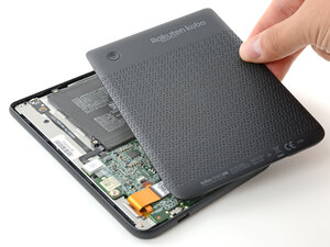

The Kobo Clara BW (N365B) can be identified primarily by its model number: N365B. You can find the model number either on the edge of the bottom cover or through the device’s settings: More Settings About Clara BW.
There are three Clara BW versions: N365, N365B, and P365. Check your eReader’s model number (printed near the bottom of the rear case) before starting repair guides.

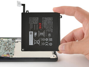

The Kobo Clara BW (N365B) uses different batteries from different suppliers. You can tell which battery you have by the 7th digit of the serial number:
  • "3" — 1900 mAh, made in China
  • "4" — 1900 mAh, made in Taiwan
