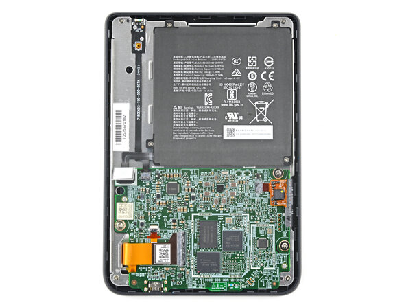

  8. Kobo Clara BW (N365B) Front Cover Replacement, Disconnect the battery: crwdns2935265:08crwdnd2935265:01crwdnd2935265:02crwdne2935265:0 Kobo Clara BW (N365B) Front Cover Replacement, Disconnect the battery: crwdns2935265:08crwdnd2935265:02crwdnd2935265:02crwdne2935265:0
    • Use a clean fingernail or the flat end of a spudger to pry up and disconnect the battery press connector.
    • Don't pull on what looks like a clear connector pull tab. The tab is secured to the socket gasket.
  9. Kobo Clara BW (N365B) Front Cover Replacement, Remove the front cover screws: crwdns2935265:09crwdnd2935265:01crwdnd2935265:02crwdne2935265:0 Kobo Clara BW (N365B) Front Cover Replacement, Remove the front cover screws: crwdns2935265:09crwdnd2935265:02crwdnd2935265:02crwdne2935265:0
    • Use a Phillips screwdriver to remove the four 3 mm‑long screws securing the corners of the front cover.

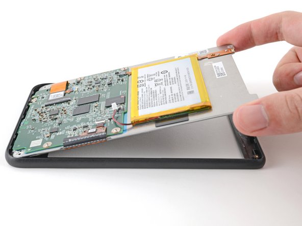

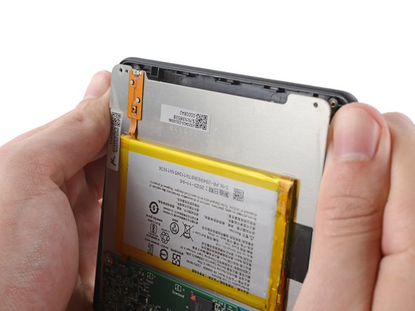

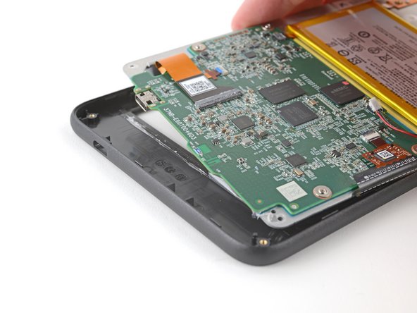

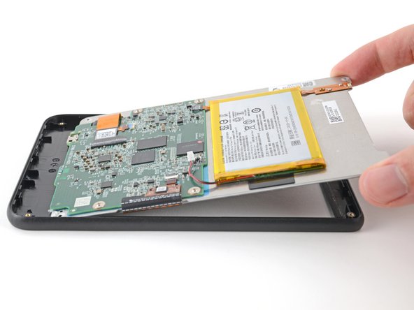

    • The screen is secured by weak adhesive along the perimeter of the front cover and a layer of coating at the bottom edge.

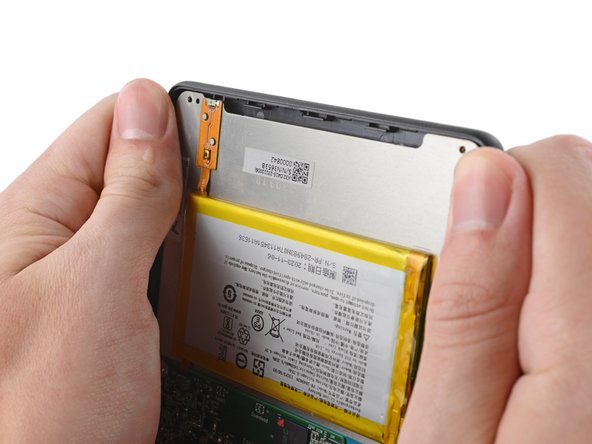

    • Bend the top edge of the front cover around the screen to separate the adhesive.
  11. Kobo Clara BW (N365B) Front Cover Replacement: crwdns2935265:011crwdnd2935265:01crwdnd2935265:03crwdne2935265:0 Kobo Clara BW (N365B) Front Cover Replacement: crwdns2935265:011crwdnd2935265:02crwdnd2935265:03crwdne2935265:0 Kobo Clara BW (N365B) Front Cover Replacement: crwdns2935265:011crwdnd2935265:03crwdnd2935265:03crwdne2935265:0
    • Lift the top edge of the screen to separate any remaining adhesive around the perimeter of the front cover.
    • Slide the screen toward the top of the eReader to expose the coating at the bottom edge.
  12. Kobo Clara BW (N365B) Front Cover Replacement, Remove the screen assembly: crwdns2935265:012crwdnd2935265:01crwdnd2935265:03crwdne2935265:0 Kobo Clara BW (N365B) Front Cover Replacement, Remove the screen assembly: crwdns2935265:012crwdnd2935265:02crwdnd2935265:03crwdne2935265:0 Kobo Clara BW (N365B) Front Cover Replacement, Remove the screen assembly: crwdns2935265:012crwdnd2935265:03crwdnd2935265:03crwdne2935265:0
    Tesa 61395 Tape
    $2.99

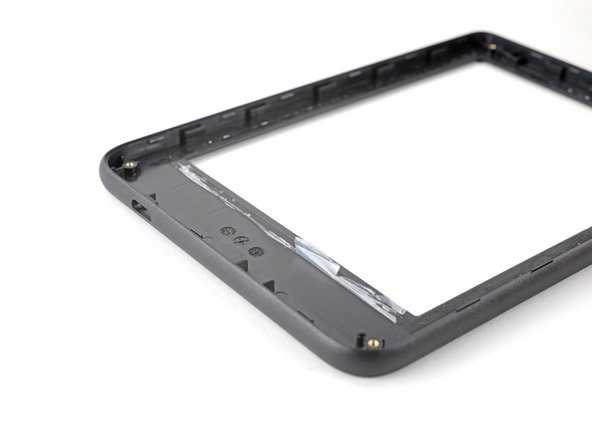

    • Lift and rotate the screen off the bottom edge of the front cover to separate the coating.
    • Remove the screen. Only the front cover remains.
    • During reassembly:
    • If your replacement front cover comes with pre‑installed adhesive, remove the liner. Otherwise, use a thin, double‑sided tape like Tesa Tape to replace the adhesive.
    • Align the front cover over the screen and press down around the perimeter until the clips snap back into place.
