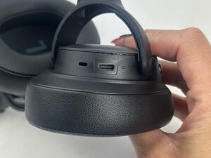

Identification
This model can be recognized by its serial number and barcode, which are located on the packaging. The product name is also engraved on the rubber flap of the headphones, and compliance icons are printed on the speaker cover. Given the variety of similar products on the market, double-check these details to confirm that you have the JBL 760NC model, as the repair steps may differ from other JBL headphone models.
