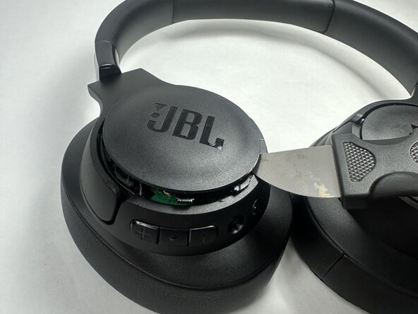

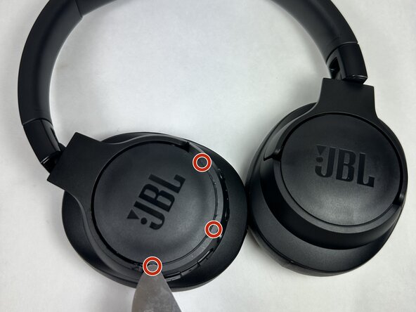

    • Power off the device and unplug any cables.
    • Place the headphones on a stable, flat surface.
    • Insert the Jimmy pry tool at a 30° angle into the seam between the ear cup and the plastic cap.
    • Pry gently but firmly to release the internal clips. You may need to try different spots around the seam for easier access.
    • Once the cap is removed, set it aside.
    • Reminder: Keep track of any small plastic clips or parts that may come loose during prying

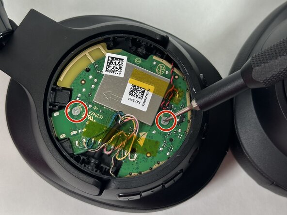

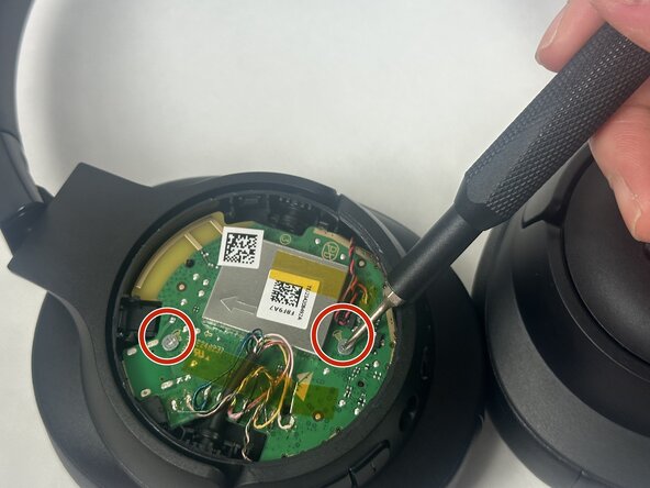

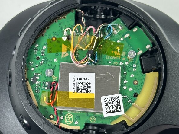

  2. JBL Tune 760NC Partially Remove the Motherboard (No Wire Removal): crwdns2935265:02crwdnd2935265:01crwdnd2935265:02crwdne2935265:0 JBL Tune 760NC Partially Remove the Motherboard (No Wire Removal): crwdns2935265:02crwdnd2935265:02crwdnd2935265:02crwdne2935265:0

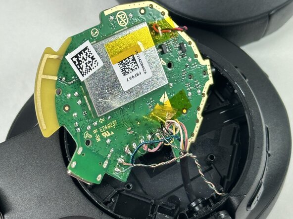

    • Identify the green circuit board this is the motherboard.
    • Remove the two 5.1 mm Phillips #0 screws securing the motherboard.
    • Set the screws aside in a labeled tray for easy reassembly.
    • Note: Labeling screws by type and location helps ensure they return to the correct place

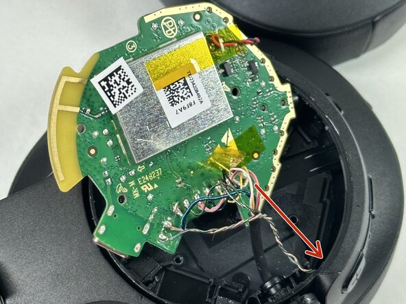

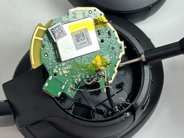

  3. JBL Tune 760NC Partially Remove the Motherboard (No Wire Removal): crwdns2935265:03crwdnd2935265:01crwdnd2935265:03crwdne2935265:0 JBL Tune 760NC Partially Remove the Motherboard (No Wire Removal): crwdns2935265:03crwdnd2935265:02crwdnd2935265:03crwdne2935265:0 JBL Tune 760NC Partially Remove the Motherboard (No Wire Removal): crwdns2935265:03crwdnd2935265:03crwdnd2935265:03crwdne2935265:0
    • Once the screws are removed, carefully lift the motherboard from one edge.
    • Do not pull or tug the board, the wires are still attached.
    • Tilt or slightly raise the board to show the connection points beneath. This step simulates how a full removal would proceed.
    • Once inspected or photographed, gently lower the motherboard back into place.
    • Note: This step is meant for demonstration or inspection only. Since the wires remain attached, avoid putting stress on any cables or solder points.
