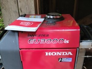

Background and Identification
The Honda 3000 Watt Inverter Generator model EU3000IS1A is designed for powering recreational vehicles (RVs) and as backup home power. Honda advertises that this generator has super quiet performance and the reliability to power sensitive technology like computers. The generator includes a Honda GX200 engine with a displacement of 196 cubic centimeters.
The Honda General Purpose Motor model GX200UT2 is an air-cooled, four-stroke, overhead-valve engine. It can be used for pressure washers, commercial lawn and garden equipment, tillers and cultivators, generators, construction and industrial equipment, agricultural equipment, small vehicles, and water pumps, among other applications. Without fuel or oil, this engine weighs 35 pounds.
The model GX200UT2 displaces 196 cubic centimeters (cc) and produces a net power output of 5.5-horsepower at a speed of 3600 revolutions per minute. The engine produces a net torque of 9.1 foot-pounds at a speed of 2,500 revolutions per minute. It can hold up to 0.83 gallons of gasoline and 0.63 quarts of engine oil. Honda recommends using unleaded 86 octane or higher fuel for this engine.
The Honda 3000 Watt Inverter Generator model EU3000IS1A includes the model number “EU3000is” on the side of the machine. The name “Honda” is printed in capital letters in various locations on the generator. The machine has a mostly black plastic body with a red metal engine cover.
