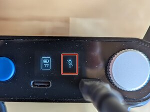

Safety features of the soldering iron include a heat-resistant cap, Touch-Safe Indicator, fall detection, and automatic idle and sleep modes. The Touch-Safe Indicator is an LED ring that lights up to indicate if the iron’s tip is safe to touch. After 30 seconds of no movement, the soldering iron enters Idle Mode, a low-power mode that cools the tip to 200 °C (configurable) to conserve energy and extend tip life. This mode will deactivate when the iron is picked up and the iron will automatically heat back up to the set temperature. Sleep Mode completely turns off the iron when the iron is not moved for 60 seconds. Like Idle Mode, the iron will re-heat immediately upon movement. The time it takes for both modes to activate is user-configurable. Inside the iron is an accelerometer that automatically shuts off the iron when dropped. While connected to the Portable Power Station, the power station will display error messages and keep them in its error log.
