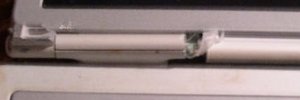

Screen hinges broken and only white screen
Both screen hinges are broken and some of the wire is displayed.

Here's photos (little blurry,not a photographer). It fell less than 18" on a carpeted floor and here's the result.
Carolina, since you have screen lightning the inverter circuitry is still working but the cable that brings image to the screen must be damaged in the broken hinge or disconnected from the LCD panel or form the logic board. Does the computer boots ? Do your hear the chime when pushing on the power button ?

I do hear the the chime and power up when I turn it on but the screen is white.
I connected it to an external monitor and I get the blue apple screen but that's all.
Could you boot from your installation disk and check if your hard drive appears in the Disk Utility window. There's a possibility that the hard drive was damaged by the impact. There's also a possibility that the logic board has a problem since you don't get video on the external. The final question is: do you really want to repair this machine or buy another one ?

I had the same problem i took the screen apart i have done it before on 3 other machines and have been successful but with this,still a white screen
i got a new screen and cable and it still doesent work it does through an external moniter so i dont know what the problem is just thought mac would have something to help this problem the design is so bad cbles cut by hinges why would you design it like that

Remember this sites name? It is possible to replace the LVDS cable and hinges. But I agree - not an easy task. I did this a few times and glued the display casing back together using cyanacrylat.
http://www.thebookyard.com stocks all spares needed, sorry but i didn't check iFixit.
The most difficult part of the job is fiddelin' the LVDS through the gap in the bottom case since the cable is really fragile.
