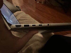

I have some problems with my Windows 11. I only get Errrors when i try to uppdate or Restore my iphones. Is it some drivers or some other things i need to do. To get it work in Windows 11. Worked just fine when i had Windows 10. But something is realy wrong in my Windows 11 Pro.

i have tried 7 Different USB port och my computer. And my USB-C Port. i only get to 50% when i try to uppdate on all 4 iphones i have. And get Code 53. And when i try to Restore i only get code 1109. And every one says Apple Devices dont work for dhem eiter on pc. Its like Apple have put som sh-t in the app so it only will work with mac.
And What is NCM DATA?
