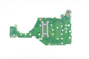

Not finding RTC or CMOS battery
My laptop showing CMOS Checksum error, and i'm unable to find the location of CMOS or RTC battery so that i can replace it. Please provide the image guide book of the manual locating that battery.
Took a look at the motherboard - this one uses the primary battery to charge a capacitor backing the CMOS RAM. If it isn't holding the CMOS settings, the primary battery is bad.
