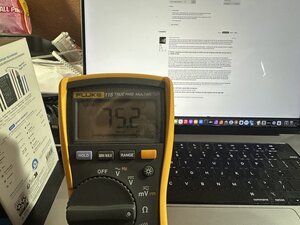

If that doesn't help (or the starter is buried in the engine bay making the whack test impractical), pull all of the spark plugs and check for oil fouling and possible engine coolant/oil mix issues. The issue now is that if you see this, you may need a new head gasket, provided the engine isn't damaged. The problem is that if you continue driving with that issue and it fails, you've likely damaged the engine so that means you may be looking at a new motor. While you do that, if you have a DMM and know the resistance values of the ignition coils, as one marginal coil can take out the engine until it's replaced. This is how the meter should be set (ignore the screen, I used a resistor on my desk to show; the exact value will be in the Mitsbishi SM):
