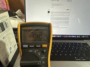

As an example as this is not an exact figure this is what you want to set the meter to when you check:
The meter I used to show (Fluke 115) is a premium midrange meter. You absolutely DO NOT NEED THIS - save your money. I have it because I got a good deal on it and use them enough to justify the high cost of Fluke.
If you can and the module isn't potted, it's probably a single resistor - maybe two - on a PCB. read the resistors directly from the PCB. If you can't do this because it's sealed, some trial and error is needed.
