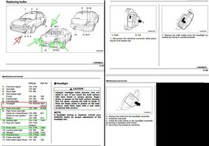

My brake lights are not working on my 2002 Also front passenger side low beam light is out I replaced the brake light switch 4 times 3 times it has melted.and I cant figure out how to replace the low beam bulb 4/24/2025

Here's a video and an image from the owner manual that shows how to replace the headlight bulb and what type of bulb is required. There is no separate low beam headlight bulb. The headlamp bulb is a dual filament type bulb i.e. low and high beam light combined in one bulb
(click on image)
