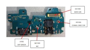

عند مكالمات لايمكنهم سماعي جيدا
عندما يتصل بي شخص ما يمكنني سماعه لكن هو لا يسمعني جيدا ،بل صوتي يكون منخفض جدا ماسبب وما الحل وشكرا

@aichabl try a headset and see if that works better. If so, then the issue is with your microphone. It is possible that there is some debris in the Mic opening or that this is a bad microphone.
The main Mic is on the sub-board, so you may need to change that board or purchase a new Mic to replace yours.
