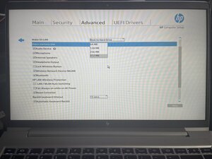

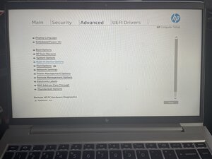

Take a look at my 640 G9. I can tweak the VRAM share but not the cTDP:
I did bump this up to 512MB from the base 64MB, but I also have 16GB of RAM, so I can waste a little bit of RAM to help it out. This one has dual channel RAM and is running on the Iris Xe GPU core, whereas unit #1 is still at 64MB being Intel UHD with single channel RAM (but I can also make it run Iris Xe with a RAM swap).
