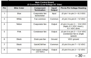

@jayeff
"manuals specifies 6.3V for the rpm and not a variable one so I assume that it would be constant from the fan."
Don't see any reference to 6.3 anywhere in the doc. Attached is a pic of the J2 connector on page 26 of the PDF.
"correct the logic may be to keep the fan at the same speed regardless as it doesn't know what speed"
The manual says it defaults to high speed
"Check what voltage is seen on it."
Will do"

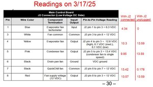

@jayeff
Found the page 30 J2 info.
I will confirm all the evap conductor voltages again including the blue wire on J2-1
Here are the readings with J2 plugged in and unplugged:
I have some comments about the readings; I'll get to them soon.
On pin 1 (pin #'s left column) - don't know if you can interpret that number vs the 6.3 suggested voltage. Might have something to do with the doc not being for this model. I have requested the correct doc from that link you sent and provided the model and s/n.
Pin 4 10.3V seems to indicate that the power provided is for something other than high speed and 13.59V means it defaults to high speed when it doesn't know, as in the case of the plug being disconnected.
Pin 5 readings seem to suggest that this doc is not specifically for this model. I know the condenser fan operates at various speeds.
These readings can be confusing bc one can not tell what the intended state of the device in question is supposed to be...
@nick29463
There will be no voltage on J2/1 on the board when it is unplugged as the voltage comes via the fan. It should be on the harness cable P2/1 though.
