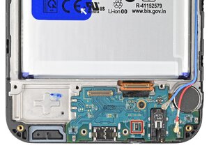

why cant people hear me when i place a call. when i make a call i hear the person loud and clear but they say they can barely hear me. i took the phone to a repair shop and they ran a complete diagnostics and said nothing showed bad or needing adjustment
Your ability to hear someone has no connection to whether someone else can hear you. When you're listening on your phone you're using the earpiece speaker, but when talking the lower microphone is where the sound goes.
The most likely culprit for your issue is that microphone. It's common for the opening or mesh to get clogged with pocket lint or dirt, muting your voice and making it hard to hear for others. Cleaning the microphone opening will usually clear up the problem it that's the issue; you may need to use some isopropyl alcohol with a brush or a tissue, or possibly compressed air or a vacuum, depending on how your microphone port is set up. Here's a picture from the users manual showing the location of that lower microphone.
Do be careful when cleaning, as the manual has a caution regarding it.
If cleaning the port doesn't do the job, the microphone itself may be defective or damaged and need to be replaced. On your phone it's located on a replaceable daughter board that's not too difficult to swap out. Here's where it is located.
Luckily, if it comes down to that, iFixit has a guide showing you exactly what you would have to do to replace that daughter board.
