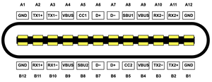

As @dadibrokeit said, finding a USB C connector that perfectly matches the position of the old MicroUSB socket will be nigh-on impossible. However if you can find a small space in the case for a 6-wire USB C female port and a couple of 5.1k resistors, you can make a basic USB 2 charging connection through a new USB C connector on your keyboard.
You can see the socket needs a 5.3mm x 12mm rectangular hole, 14mm deep. You may be able to enlarge the hole for the MicroUSB socket, but failing that - a shallower hole and some hot glue will keep the new socket in place.
Solder the Vbus (red), D+ (blue), D- (white), and Ground (black) wires to the PCB connections for the original MicroUSB port: Vcc, D+, D-, and Ground:
Then "pull down" both the CC1 (green) and CC2 (yellow) wires by connecting each to Ground through a pair of 5.1K resistors.
By adding those two "pull down" resistors, you tell any power supply, laptop, TV etc. connected to the far end of the USB C cable plugged into your new USB C port that you need 5V power on the Vbus lines - which will power up the Vcc line on the old USB 2 interface and begin charging your keyboard. Hopefully.
The socket will still function even if the cable is reversed because a USB C socket has Vbus, D-, D+, Ground and CC(x) pins symmetrically placed on both sides:
