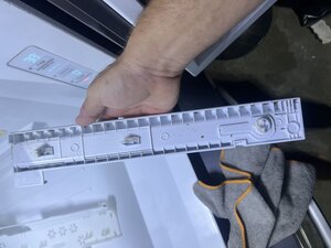

Anyone know how to remove the Crisper Drawer Slide Rail DA97-11291A
In need of help on how to remove the Crisper Drawer Slide Rail on a Samsung RF28HMEDBSR/AA Rev 14 Refrigerator. I can't find instructions in the service manual or online. I have the new part. There are no screws holding the old slide rail in place. Link for part reference. Samsung Assembly Rail Veg-R - DA97-11291A

Hi @rickyt76527
Just verifying that there's no screw in the rail?
Looking at an image of the rail using the part number you posted, it shows that there is one.
It isn't under a screw cap by any chance?

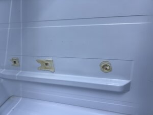

Further images in the link show clips on the back, so presumably once the screw has been removed, the rail can be slid (not sure which way, forward or back), to unlatch it, allowing it to be removed.
Expanding foam is what holds it in place. There are no screws holding it on, no caps to pull off. You have to, VERY SLOWLY, start at the front and pull it away from the wall, for the foam to release and once you get to the last “clip”, you have to start pulling forward at the same time. It will eventually release. For anyone still searching for the answer. I looked at the design and bit the bullet and pulled it off.
