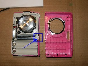

How can I replace my broken battery door. Cat knocked it off the table and broke the battery door. I can get the same camera for parts but do not know how to actually make the repair without damaging the camera.
@cwcat you can use this guide Sanyo VPC-S1415 LCD Replacement and remove the back and front cover. You will see a small roll pin that holds the door in place
That pin needs to be pushed out to remove the door. word of caution. There is a spring between the pin and the door. Take a look on how it is placed so you can replace it, once you have the new door.
