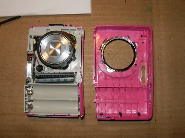

      • Split the camera from the battery compartment down. You can use an opening tools, or just your fingernails, if so equipped.
      • This will remove the front part of the case.

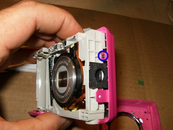

      • Remove this screw on the right side of the camera. Keep it separate from the 4 screws previously removed. The are of different length

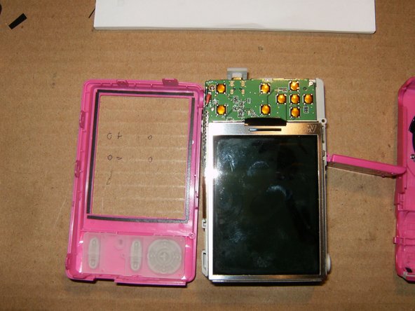

      • Flip the LCD to the right and out of the frame. Do NOT try to remove it yet.

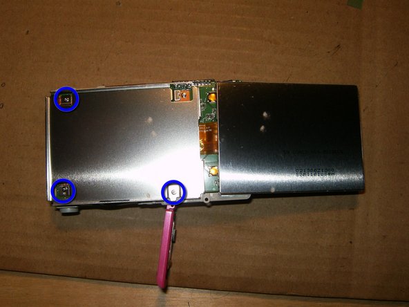

      • Remove the screw screws that hold the LCD frame to the logic board. Keep the 3 screws separated from the rest of the screws, due to different length.

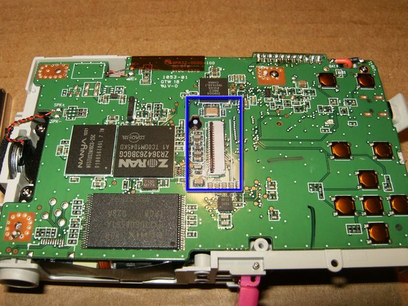

      • With the frame removed, the connector and LCD cable are now fully accessible. Note the to tabs on the cable and their position on the logic board.
      • Flip the tab on the connector carefully up and remove the LCD.

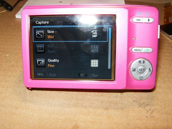

      • Hopefully this is what you will get after replacing the LCD and reassembling the camera in reverse order. Total replacement cost was $15 and 30 minutes of my time.
