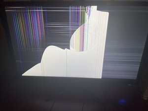

Where can I get a power supply? Acer GN246HL
Found it in the trash, couldn’t find the power supply. Which adapter does this one use? From what I was told it should work but they got a new one.

Adapter specs are Input = 100-240VAC Output = 19.5VDC, 3.42A, DC power plug centre +ve 5.5mm x 1.7mm
Here's the user manual as well
Looks like a standard laptop adapter Acer adapted for a monitor as well.
Well I checked it with a 12V which has done me good multiple times and she’s dead jim.
