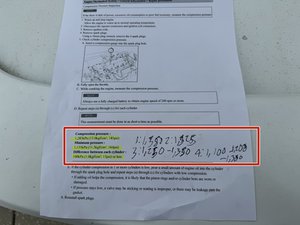

This is what the page should look like (Note this is an EXAMPLE; find the SM for your Rio and locate the info specific to yours):
That said, here's the specific data for yours.
