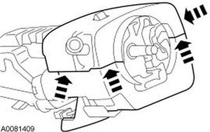

Headlight hi/low beam switch replacement
Replace hi/low switch on headlights of 2007 Ford 150 stx
@charlesharner sounds like you are talking about replacing the
Steering Column Multifunction Switch

Removal and Installation
  1. Remove the steering wheel.
  2. Remove the lower steering column shroud screw.
    1. Apply inward pressure to the upper and lower shroud cover seam to separate them and remove the lower shroud.

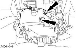

  1. Remove the 2 screws and the upper steering column shroud.
    1. Remove the screw, release the tab and position the multi-function switch aside.
  1. Disconnect the multi-function switch electrical connector.
    1. Remove the multi-function switch.
      1. To install, reverse the removal procedure.
This is how the service manual describes it.
Those that have replaced the switch know it is NOT necessary to remove the steering wheel or mess with the airbag. Check this video to see how to change it without the removal of the steering wheel etc.
