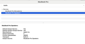

Looking at the Output audio settings under the Sound prefs what do you see? Do you see the speakers.
Then go to the About This Mac and click on the System Report button to open it up, click on Audio and then click on Built-in Output. Post a snapshot here so we can see it as well.
Of course....all the speakers are shown as normal, volume can be adjust and so on. They show up normally on Sound control panels....and they are reported by the System report at totally normal.

MacBook Pro Speakers:
Default Output Device: Yes
Default System Output Device: Yes
Manufacturer: Apple Inc.
Output Channels: 2
Current SampleRate: 48000
Transport: Built-in
Output Source: MacBook Pro Speakers
@craigissod - Well that’s good, so the issue is either within the amplifier logic or a loose wire within the analog side of the circuit.
