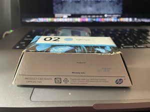

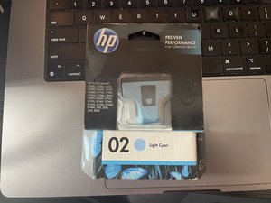

I looked into it to see if this is the HP 02 mechanism, given I recognized the model as a potential "02" printer. HP discontinued new manfacturing of 02 ink carts in 2020
Unless you have any really fresh stock of NOS 02 ink, any extras you have are likely shot. If it looks like this, it's generally going to be toast in almost every case (this one was likely made in 2013 based on the date info):
UNLESS YOU HAVE A GOOD 3RD PARTY SUPPLIER OR INSTALLED CISS CARTS, this will play into my answer. I have found them in random ink lots as NOS, but these things are ancient and probably no longer work when they're actual NOS OEM HP. These do not shake like Epson and Brother, so this isn't a liquid carrier; the carriers WILL EVAPORATE over time in storage.
