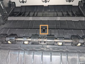

I ordered this printer 3 months ago and Lexmark support has come back to say it's unfixable. But from the first boot up it registers a paper jam (front).
No paper has ever been put in the printer.
Does anyone have any idea what sensor I should check?

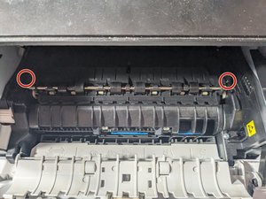

With that out of the way, here's the issue: The sensor inside the toner compartment is probably broken and needs to be replaced, or there is paper under the cover, which can be cleared by taking the two screws marked in red (use a stubby screwdriver unless you want to remove the side panels and top cover -- there is no working room without removing the top panel on this model). Use a small object like a toothpick to see if the sensor moves freely. If it does not, the sensor is broken and needs to be replaced, as it is creating a false jam by being stuck in the closed position too long.

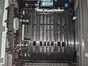

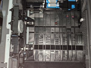

The sensor is towards the bottom of the printer and is a bit tricky to replace AND requires significant disassembly :-(. I have attached photos to show how much of the printer is inaccessible from the bottom with this particular unit:

Appreciate it so much. Checked the sensor and it's squeaking when moved and takes a bit of effort to move it. Blew it out anyways with the air gun and nothing so most likely looking at replacing the sensors. Still getting
Paper Jam Front 200 91B as the error message. Can't even clear it off the screen just keeps flaring back to that.
@switchhear Mine came back but I jammed it on purpose to locate the sensor.
@switchhear Maybe if you can take it out and put something like dry lube on it it'll help? I'd still buy one and expect failure. Wet lube isn't going to be great for a part like this.
